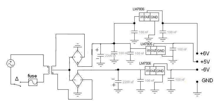

A little help with my university project please...
Nigel Goodwin said:
It's still wrong and completely useless!.
whats wrong there's nothing wrong with the diagram. i try it in tina pro
its completely fully functional.
The two positive supplies don't have a main 2200uF filter capacitor. Therefore when loaded they will have severe voltage fluctuations as ripple.
Two bridge rectifiers are used when only one is needed.
ok, sorry tnx,
here's updated

Your simulator didn't catch the mistake of the missing filter cap because the regulators weren't loaded.
You still have two bridge rectifiers when only one is needed.

muki55:
1st:
Use ONLY ONE bridge rectifier if you want it working is real life;
2nd:
The configuration of your design is for use when you have 2 isolated secondaries. In this case, it's a normal secondary with central tap;
3rd:
Just for curiosity, I tested in my bench your design! Great! Only noise and heat!!
Unfortunally, I didn't take any picture to show the output waveform here, sorry. But is very ugly!:p
So, my design is the best for any need, as far the output current don't exceed 1A. The 2.200uF cap in the positive can be changed with 4.700uF if some ripple is noted if both +5 and +6V are loaded.
The transformer can be 8-0-8V 30VA. This it is enough and don't make regulators heat!
This is my opinion and my help.
Cheers,
Pedro Martins

Haven't you been listoning?
Read the thread from the beginning, you only need bridge one rectifier and it's highley recommended you put the switch and fuse in the live/phase/hot/line conductor and not the neutral/cold conductor.

Hello everyone, after changing to LM7906 everything worked perfectly..
In a few hours i'm going to give it.
Thanks to everyone for your help!
