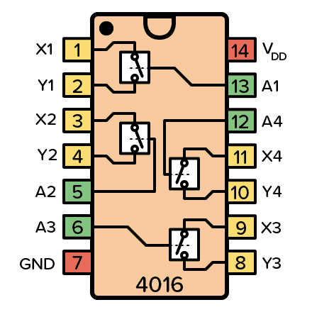

Something like these?
Thanks guys, but I'm really looking for a discrete circuit rather than an IC solution.
