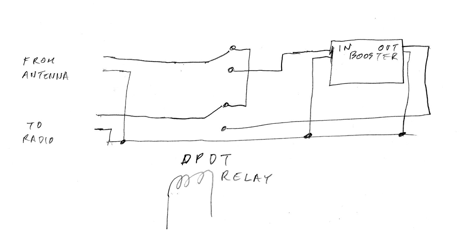

I am not clear what you mean in this statement in post #3 "I tried connecting the center conductors and outer braids on both ends together directly to bypass the booster and that made the reception worse." This sounds the same as plugging the antenna straight into the radio. (Or do you mean that you shorted the input and output of the booster together ?) This is how I would bypass the booster using a DPDT relay.
The booster would be in circuit when the relay is energised as the circuit is draw but could be changed to work the other way round by swapping over the NC and NO contacts. Another solution may be to switch in and out an attenuator on the output or input to the booster amplifier. The choice of inserting the attenuator in the input or output depends on weather the overloading is occurring in the booster or the radio. One problem with this approach is that the impedance is probably unknown so making the attenuator would be trial and error. (Rather than being able to calculate the values.)

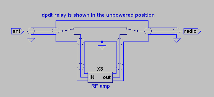

This is what you should be doing. Note that only the center-conductor is switched..., but the coax shield is continuous.
thebestofall007
That looks to be what I need except I probably will be using a pair of SPDT relays I found, one at each end of the signal chain like you pictured to do this and make the circuit on a double sided board, one side the circuit side and the other a ground plane. I have a metal project box as well. Would this work?
Should work. I have used normal (small) relays for antenna switching at 2m (144MHz).
