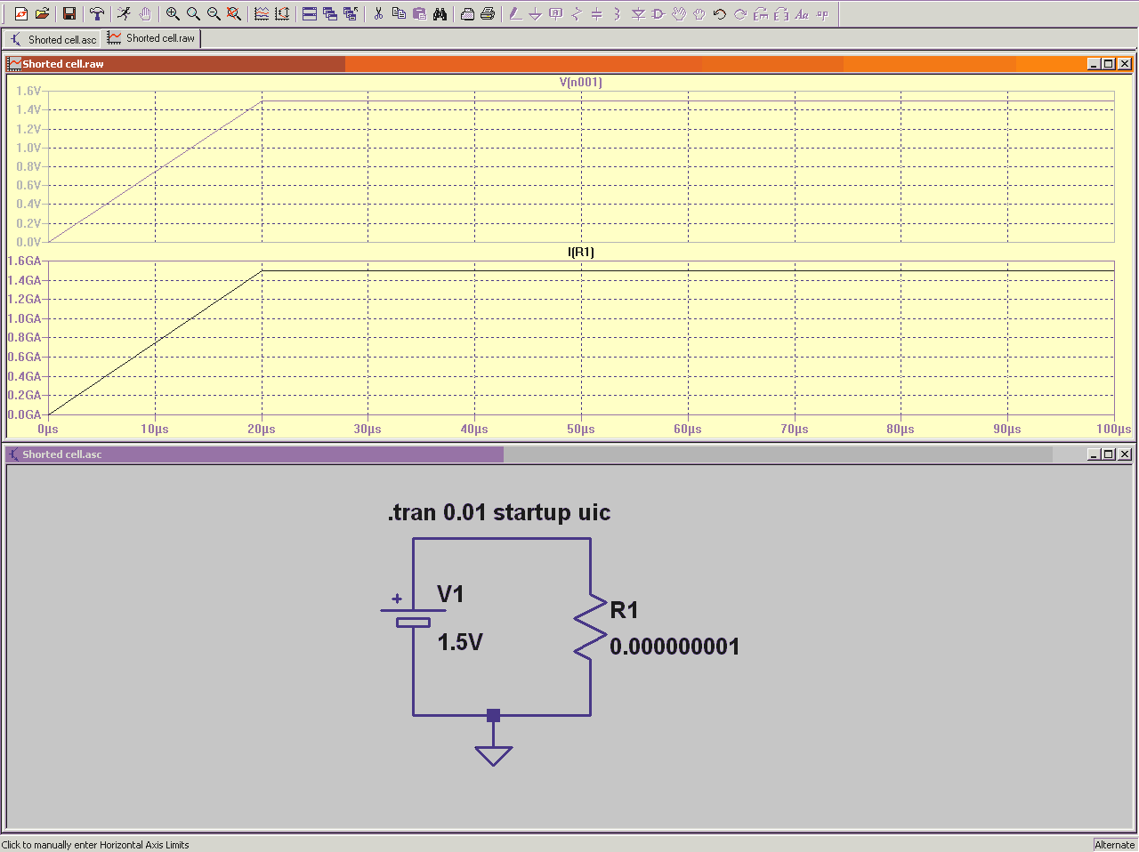

LTspice simulation loses
Well, dang: LTspice is no help here.
In my simulation (with R=0.000000001Ω), current happily goes up to 1.5GA. No asymptotic rise to anything.
Any way to fool SPICE into working with zero resistance? How about a non-linear resistor that reduces resistance as current increases?
  • Shorted cell.asc
    Shorted cell.asc
To use LT Spice, you need to set up the resistor as a parameter, and use .setp param... to diminishing resistance. The problem is now that you need to set up an equation for calculating power ie i(R)*i(R)*R. Problem here is, LTspice doesn't conisder R as a tracable quanitity, so the equation doesn't work. The only way I can think is to plot I and then do the power calculation by hand.
PS: I did a few hand calculations and noted that the power rose with diminishing resistance ( approaching zero ) I expect the power to rise monotonically. Thus I conclude that power at zero resistance is non-zero.
