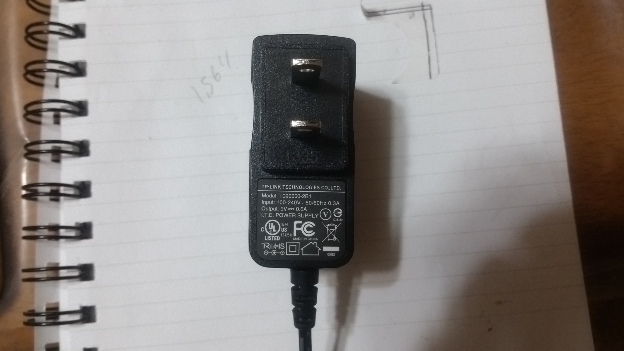

I would like to build a regulated 9 volt D.C. power supply that uses 115 v AC to supply low current circuits.
The plan I found uses a power transformer, voltage regulator, zener diode, transistor, and some capacitors.
My wall transformer puts out .6 amp which is more than I need. There is no way to take it apart without destroying it.
It weighs 44 grams( or about 2 ounces) so I am wondering if it uses a power transformer.

The power supply in your first post is a flyback type, high frequency switch mode supply. It does use a transformer, although in a flyback converter it's more accurately called a coupled inductor.
But that transformer can only be used as part of a circuit like the one that it's in. You couldn't use it as a normal line frequency transformer.
I am using it with my laser alarm circuit.
Weight is not an issue. Using a power transformer along with zeners, etc. would be fine.
I am using 2 AAs with my laser.
I am also wanting to power it from an AC source.
