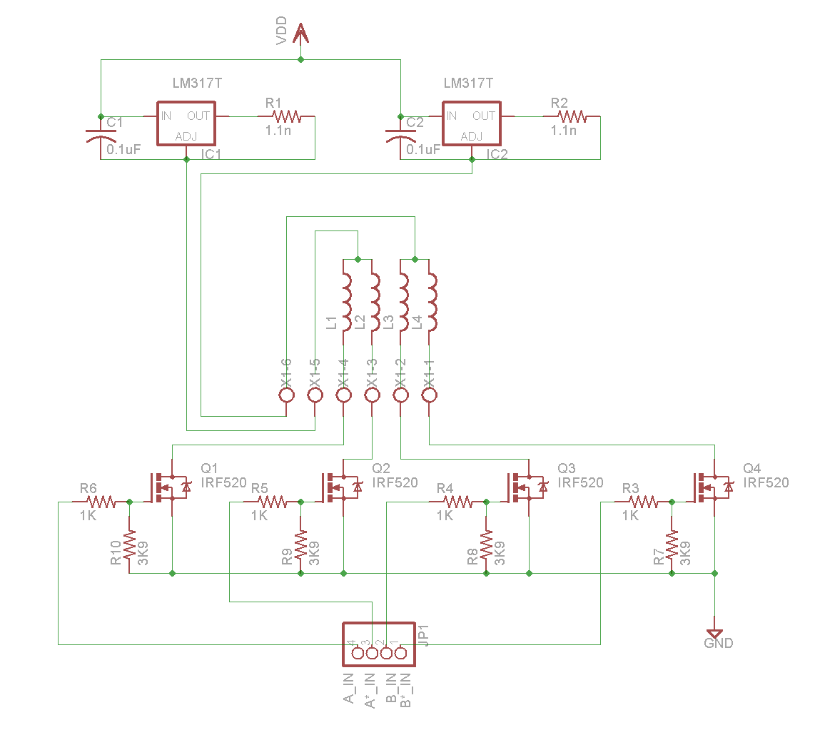

mneary,
Sorry if I seem to have changed the discussion. In my mind I have been talking about a (stepper) motor all along. In any event, I have enclosed a circuit diagram (that I originally noticed from PMinMO on a CNC site) that I am ultimately hoping to change to allow for a larger motor (it does not have the current limiter that I originally described, but a LM317T based one). Currently it is restricted to ~1.1 Amps (I think!). I will almost certainly take Hero's suggestion and incorporate a couple of polyfuses into this scheme.

Where would the comparator with hysteresis go? I currently have no idea what you are talking about, maybe if I see it I will recognize it. Sorry for being so dense.

If your stepper doesn't have to achieve maximum speed or acceleration, then you can limit current by setting its Vdd to that voltage which causes the desired 8A to flow through the stepper's winding(s). All of the steppers that I've run in current-limited 24V (chopper) mode would work just fine without any current limiting circuit, at 5V or so.
