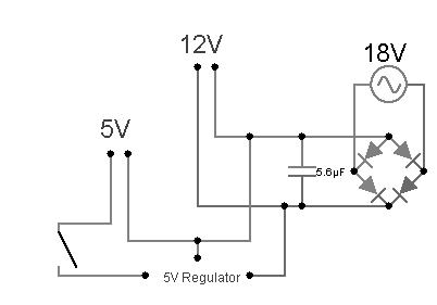

I've attached a circuit diagram to show what I'm trying to do. The 12V terminals have an external switching module connected to them, and it switches the 5V supply, which goes to a motor. The idea is to replace the two separate 5V and 12V supplies I'm having to use at the moment.

You say:
"I put together a primitive power supply with a 12V DC output straight from the rectifier, and a 5V DC output which was achieved using a 7805."
So you have AC going to this bridge?
Your bridge is wired wrong.
You need to reverse two of the diodes.
18VAC makes a peak voltage of 25.4V which is reduced to 23.4V by the bridge rectifier.
The 5.6uF capacitor has a value that is way too low for a filter so the "12V" is pulses of 0V then +25.4V then 0V then +25.4V over and over.
The motor starts on one +25.4V pulse then its inductance causes a very high voltage as the supply voltage drops to 0V and the high voltage spikes destroy the 5V regulator.

Change the 5.6uF cap to something a lot bigger like a 2200uF or 4700uF. Observe correct polarity and voltage ratings. As noted by AudioGuru, 18VAC will become 24V when rectified and properly filtered. Change the transformer to a 9Vac or 10Vac one so that you get apx 12Vdc unregulated.
Also, add a 0.1uF cap on the 5V side of the 7805.
Will try with a bigger filter capacitor, and an extra one on the other side of the regulator.
I specified the transformer wrongly in my diagram, it's 18V in that it's +9/0/-9 centre tapped, and I'm just using the +9 and 0 terminals. So I should have drawn it as a 9V one. There is definitely 12V DC at most between the two sides of the rectifier.
The rectifier is correctly shown, though, isn't it? (Circuit Simulator doesn't have a symbol for the IC rectifier that I'm actually using. It's got +, - and ~ ~ clearly marked, enabling me to connect it properly).
While that will work, the way to get the most power out of your transformer, and still have 12Vdc output, is to connect it like this:
Yes. :)
Flat5 was in error on that point.
