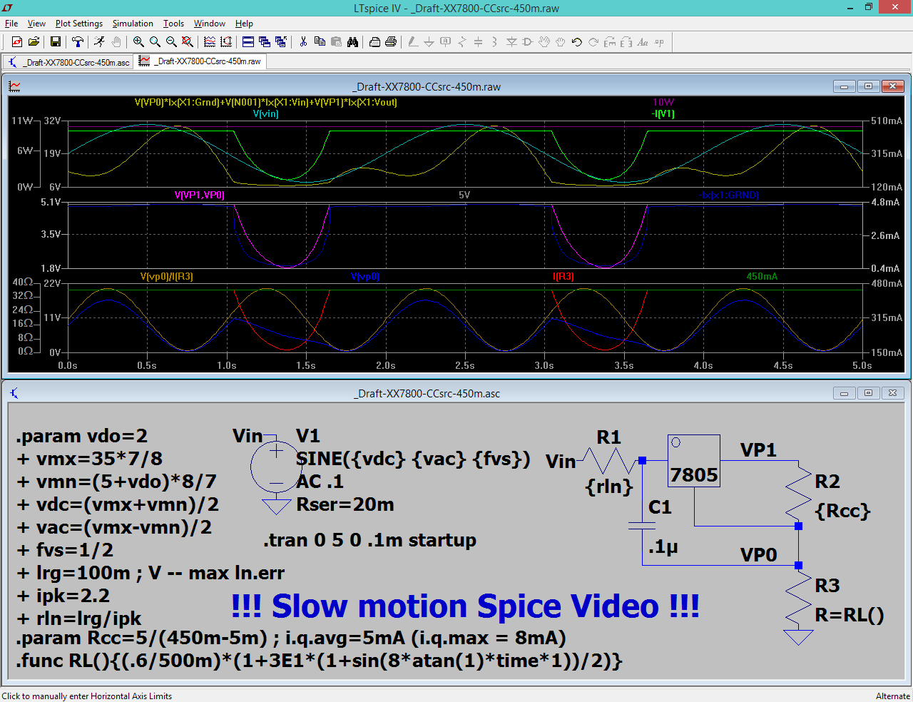

I need to design a constant current source of 0.45A using the voltage regulator 7805. Can someone let me know how to go on about it?

there's some calculation examples
https://www.circuitstoday.com/fixed-positive-voltage-regulators
  • spice check
    notice the 10Watts on 7805 !!
