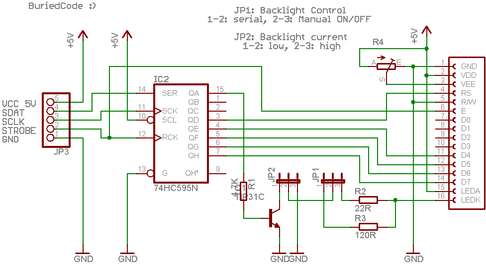

I use the 74HC595 or the 4094, both work quite well. I tend to use 3 wires though, and the 4-bit mode interface. D7-D4, RS, and backlight. E tied to the strobe line.

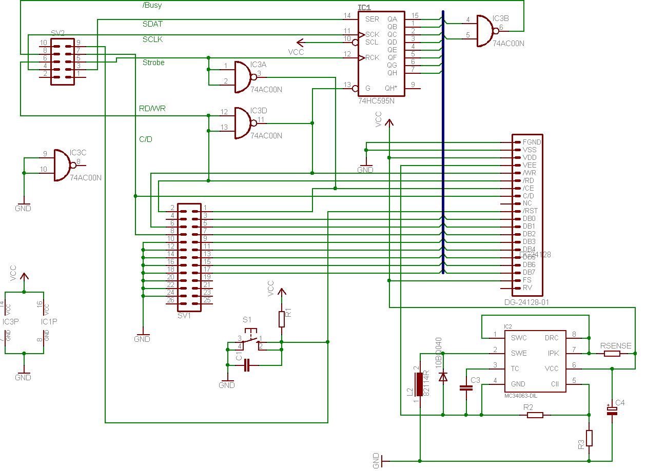

I've also used shift registers for T6963C based LCD's. With a couple of NAND gates you can have a 'busy line'. I'll post if people want it..handy for getting a lil F88 hooked up to a 240x128 LCD as well as EEPROM/FLASH for bitmap storage.

Hey. The 'busy check' was only for the T6963C controller...although I guess it could be adapted for the character LCD's....I usually just wait the maximum time, using a spare timing interupt or something.
With the graphics controller....theres no minimum time given in the crappy datasheet, plus speed is at a premium when you're drawing bitmaps/updating info on a large LCD, so a busy line is handy.
When the strobe isn't clocking data into the LCD, the tristate output of the 595 is disabled and the LCD set to 'read'. Theres two bits which determine 'busy', so AND those together and you've got a 'busy line'. Its another I/O but still handy as its just a low/high.
For character LCD's I've just used 74HC595's, or 4094's. The 595 has a nice pinout for I/O expansion but for LCD's, the 4094 has much nicer layout. here's a couple of schems I did ages ago when I was fed up with prototyping with character LCDs and using so many I/O's.
Not worth posting both, as the 595 is pretty much identical in functionality to the 4094. Sorry for large schems, since I went with '4-bit mode', theres for spare SR outputs for controlling the backlight. You could use 8-bit mode and use the data or clock input to the RS line..but I can't be bothered disabling my SPI port's I/O's just to set/clear them. At least this way SPI handles it in a couple of simple routines.

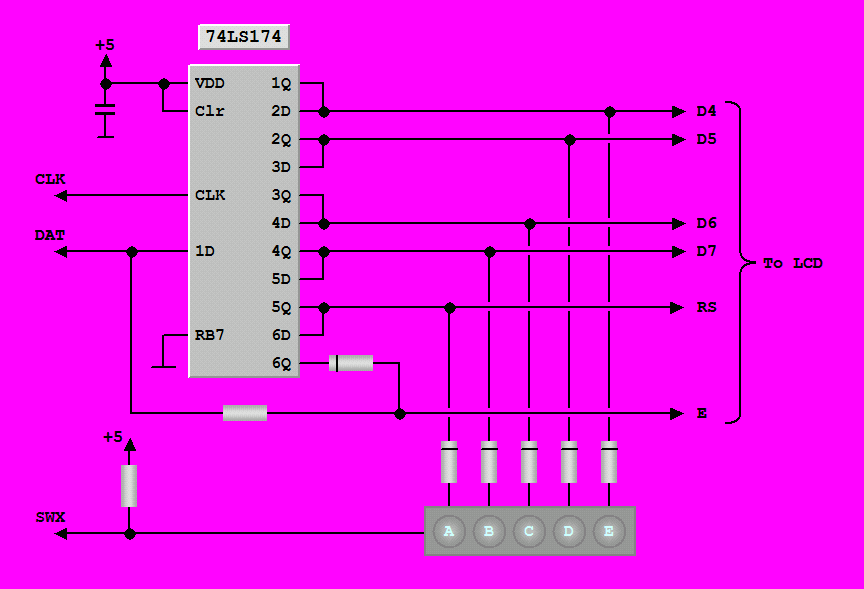

Also wondering if we couldn't exploit the 74LS174 circuit by taking advantage of it as a six bit latch (without setting data = 1 for the 'E' strobe) to drive the column line on a set of switches or select columns on an LED display, etc.?
Bill (blueroom) showed us his 8 bit SPI latch on another thread which can be used for an LCD display (amoung other things) and I'm currently adding 4-bit latch capability to my 12F635 serial LCD driver (using a new control bit in each serial byte that will enable or disable the E strobe for that byte).
Mike
