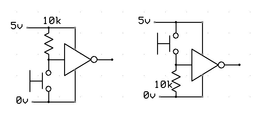

As Roff said we must never leave inputs floating. That is why you use pull up or pull down resistors. These resistors stop the inputs from floating by connecting them to 5v or 0v until a signal arrives.
If a signal consisting of a logic level low is given to the IC (to give a high output) you would use the pull up circuit, the one on the left. The pin voltage will be at 5v all the time, unless a 0v signal drives the pin low. For simplicities sake I have just drawn in a switch, in you circuit it may be a transistor or sensor or whatever.
If your signal is a logic high then you must use the diagram on the right, it is a pull down circuit. It is just like the pull up circuit, but does the opposite. It holds the pin at 0v waiting for the signal to drive the pin voltage high.
In each of the circuits I have stated to use a 10k resistor. This resistor can be virtually any value, as long as it's not too low. I try to keep them above 2k, but if you have lots of 1k2's, they will do just as good. If it is running on batteries, try to use larger values 10k+ this way they standby current is kept to a minimum and the batteries last longer.
These circuits are in most digital circuits, they avoid noise, inconsistent results and a lot of other things.
