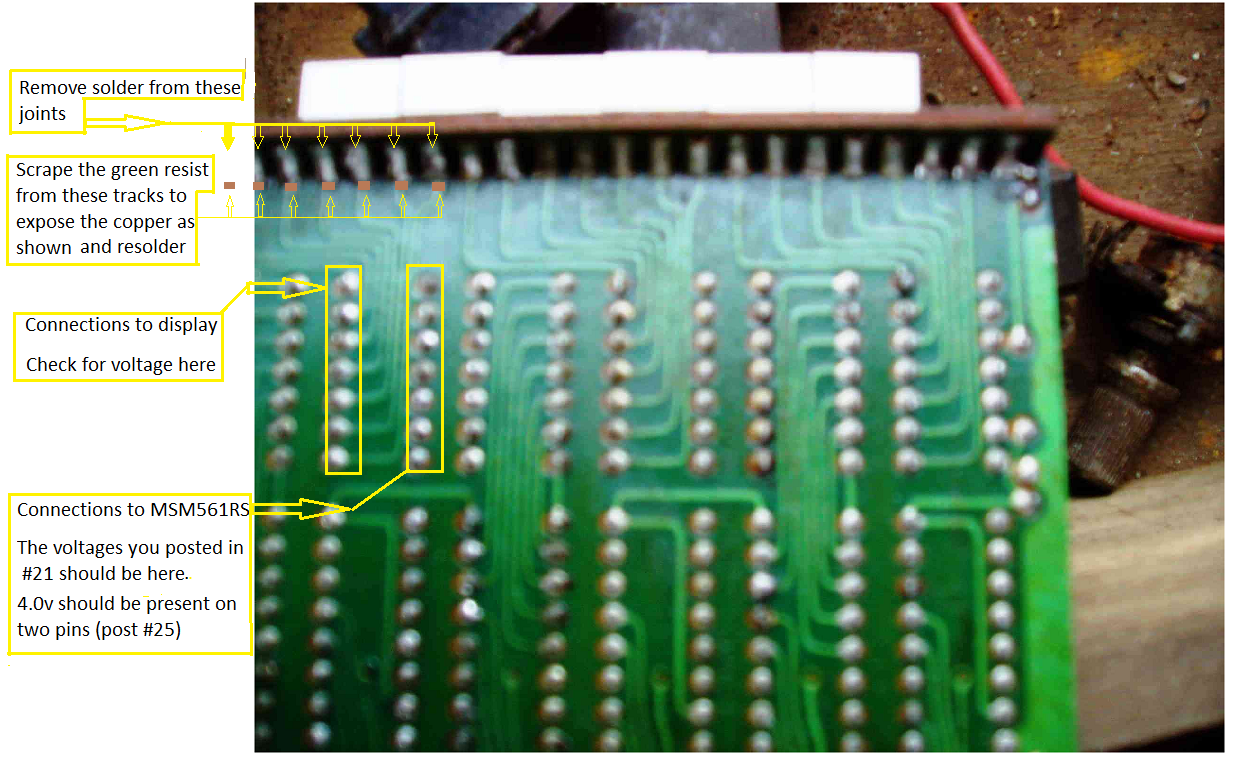

Hi april, to display "4" there should be voltage on pins 2, 3, 8 and 9 of the display. Please post the voltages on the resistor array pins, R806.
A picture of the solder side of the counter board would help me to give you specific points to check.

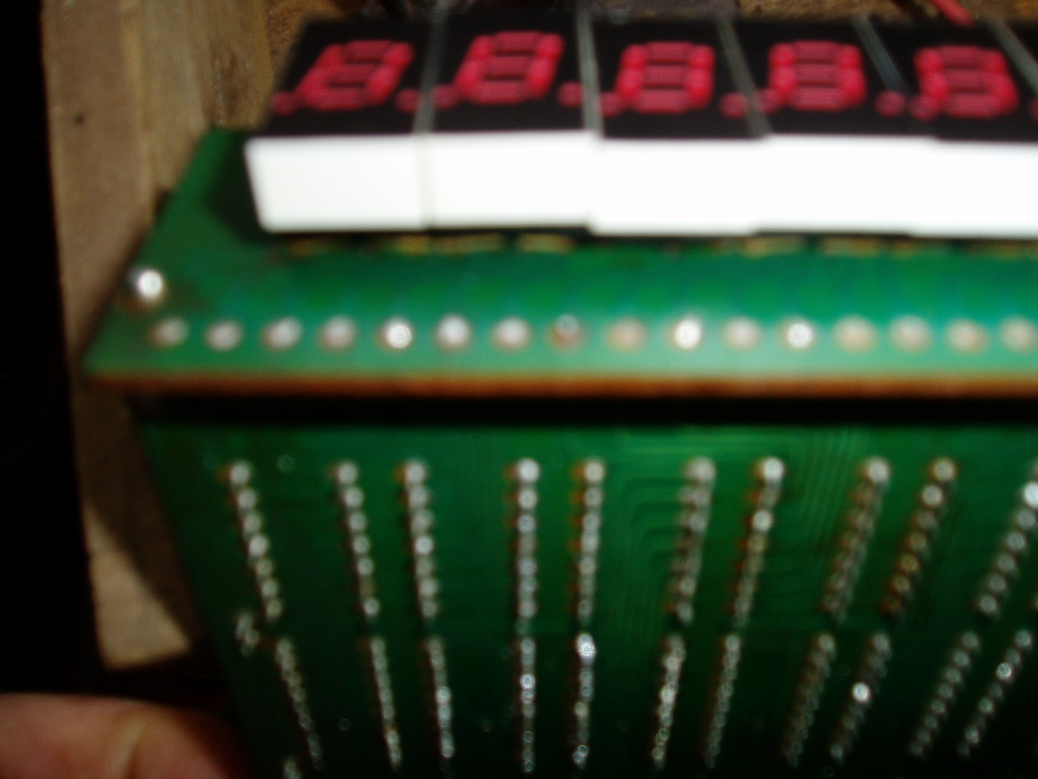

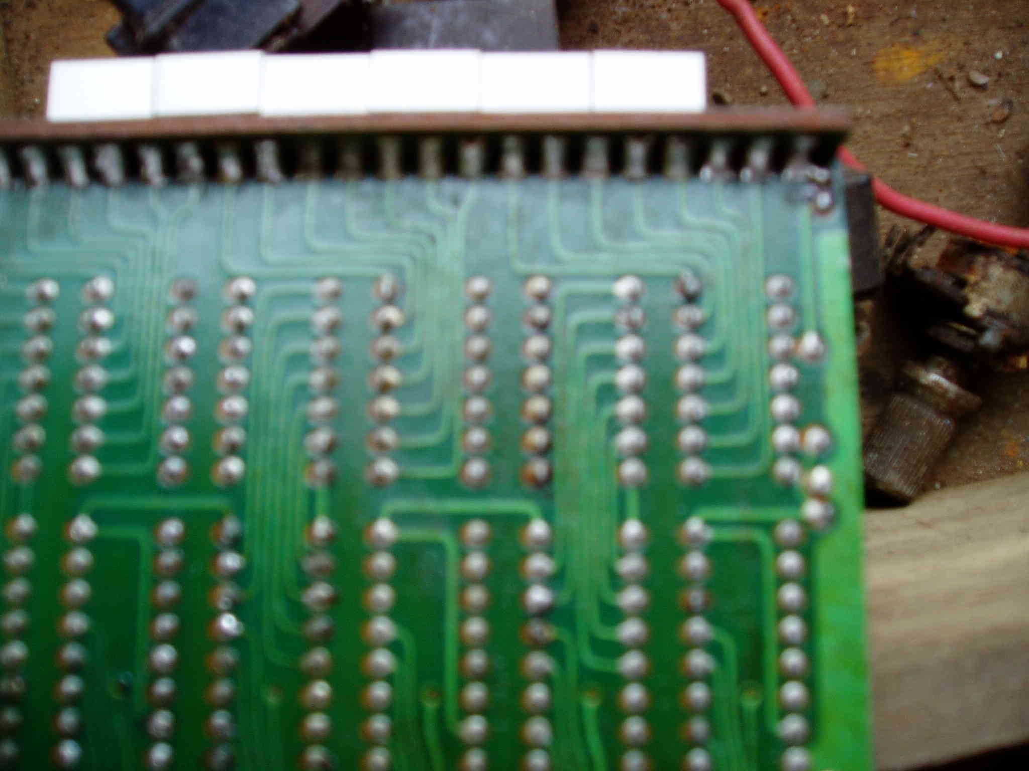

I have taken a poor photo of the board bottom with the camera I have available but I dont think it will be needed anyway now

Hi april, we are almost there. You will need to find a way to set up the unit working in the position shown. Set the unit to the same conditions in post #21 when you listed the voltages. Check the voltages I have indicated in the attached "Test points". The brown areas indicate where you should scrape the green resist coating to expose the copper and re-solder.
A picture is worth 1GB so you could right click the image and "open with" paint to add text etc to it.

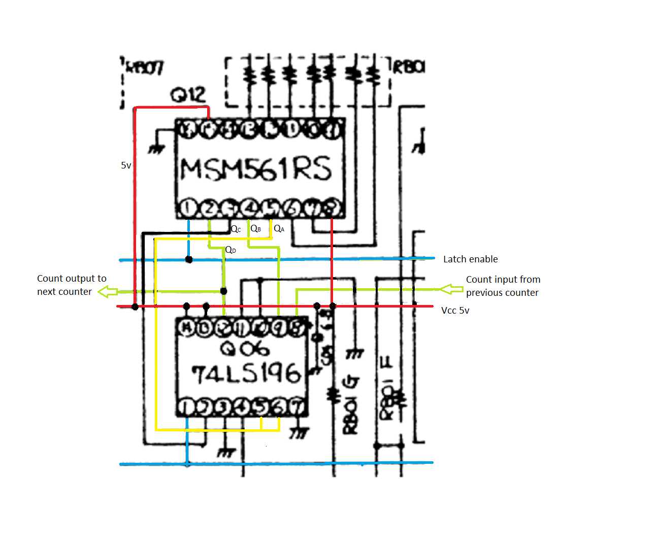

I do not think so. I have attached a snapshot of the relevant part of the schematic from the manual and added some colour to make it easier to understand.
I can not find the datasheet for MSM561RS but the connections are as follows:
Qa, Qb, Qc and Qd are the inputs (the count outputs from the 74LS196) pins 5, 4, 3 and 2 respectively.
The outputs to the display are pins 6, 7, 9, 10, 11, 12 and 13.
Pin 1 is the latch enable input.It is common to all the MSM561RS so this is not the problem as the others work. You can check for continuity between pin1 of Q12 and the others.
Pin 14 is open and pin 15 is tied to 5v.
The other two pins left are ground and +5v.
How did you measure continuity to the display, between which points?

I found the diodes are connected inpairs except for first and last . All checked ok
Continuity was checked from either side of the 330 Ohm resistor to the display pins and then the other side back to the pins of the MSM561RS.
So this has confirmed the lines you speak of removing the solder from. There are no voltages on the display pins or the resistor pins or the MSM561RS except for input pos line now so it changes . Anyway I will get the voltages at the points you mention and do the solder points and clean back anyway so Ill post back when able . Thanks very much for spending the time Timescope.

I suggested earlier that you set up the counter to work without the metal chassis so you can measure the voltages under the board. You could solder a wire to the ground of the circuit board and wrap the other end around the negative probe of your meter so you will have one hand free and a solid ground.
I have also been looking into the possibility of invalid data at the input of the MSM561RS. Some display decoders blank the display when the input data is invalid (greater than 9 , binary 1001) like 4511.
The 7447 decoder has a RBI (ripple blanking input) pin that blanks the display when it is L (logic 0) and the input is zero (LLLL). This removes leading zeros for example, 14.5 is displayed instead of 00014.5.
This may be the function of pins 14 and 15: pin 14 is open and pin 15 is H (5v) for Q8 to Q12, pin 14 is grounded and pin 15 is open for Q13 (tens of thousands).

The experiment you did with the display indicates that the MSM561RS is defective: the display is working and the 74LS196 is ok because it is able to drive the next counter.
