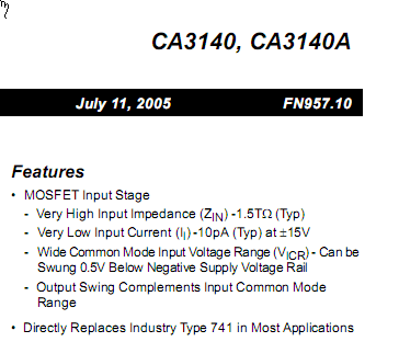

hi Andrew,
I use the CA3140 as direct replacement for the 741.
