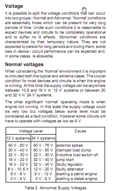

hi B,
The problem with vehicle battery supplies is that they are VERY subject to electrical noise.
Positive/Negative transients and voltage pull down while engine starting.
So you would need heavy filtering, which should include resistive dividers to reduce the 12V/14V input signals you want to use, down to +5Vmax

Hmmm, alright. I will look into this. A transistor circuit to drop down voltage to 5-6V range will work. I just made an tested the circuit.
