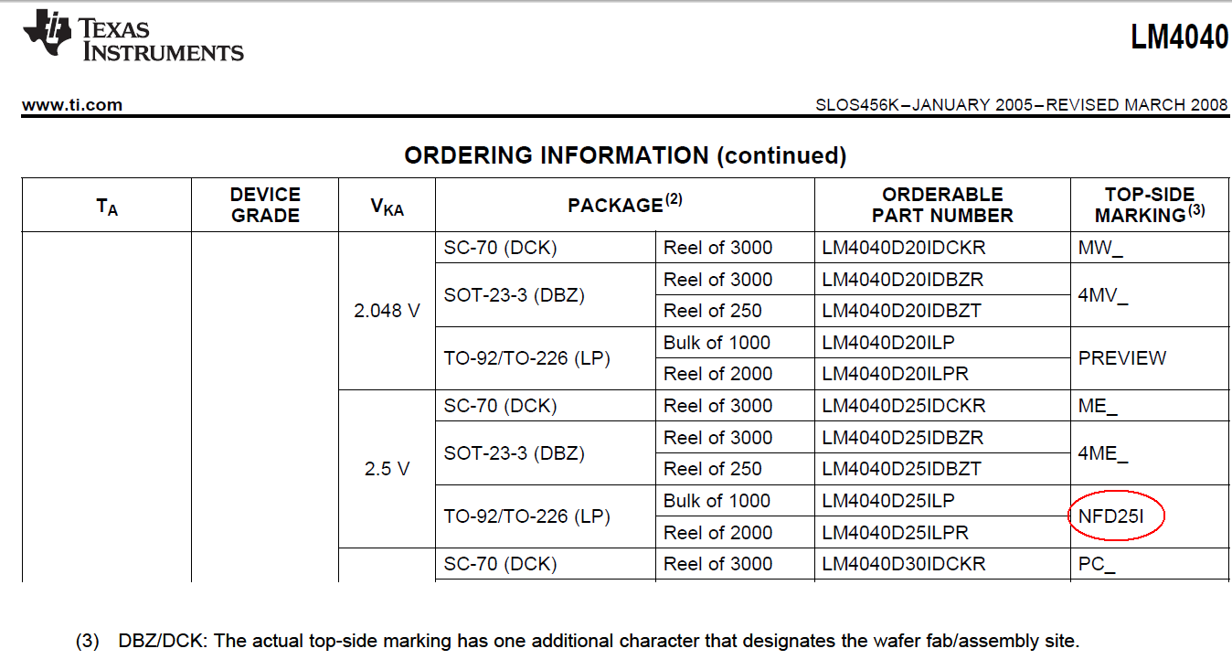

I just found 25 nice new TO-92 parts (cut tape) in a drawer. I'm not sure what they are, but I suspect they're the (Digikey number) 296-21583-1-ND 3-volt reference shunts I ordered a while back.
But what confuses me is that they're labelled as follows:
1st line:
73M716E
2nd line:
NFD301 or NFD30I (can't be sure which - probably I)
3rd line:
T1 or TI (again, probably I)
When I look up the Digikey number 296-21583-1-ND from my order I find the Texas Instruments LM4040D30ILPR. I've Googled and searched all the major electronics suppliers for 73M716E and NFD301/I and come up with nothing at all.
I'm about 80% sure these are my 3V shunts, but would like to be 100% before I plug them in. Also I'm wondering why the strange labelling? Any ideas?

They must be the ones. Looking at the datasheet, you can see that they are not marked with an actual part number but a coding scheme similar to the NFD30I number:
Ah! I didn't spot that. That pretty much moves my probability up to 95% of them being what I think they are. Maybe I'll find time to test one on Sunday.
