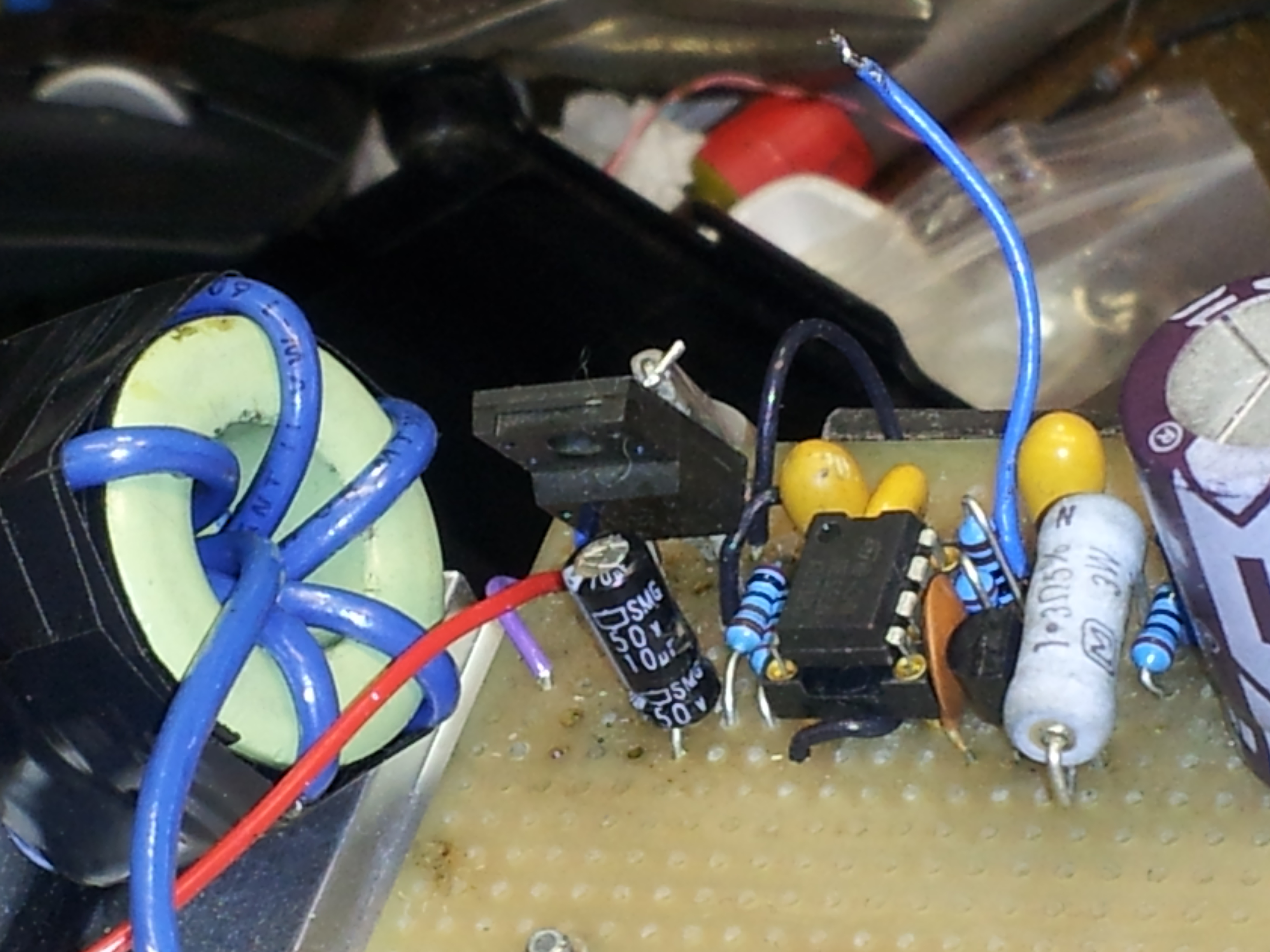

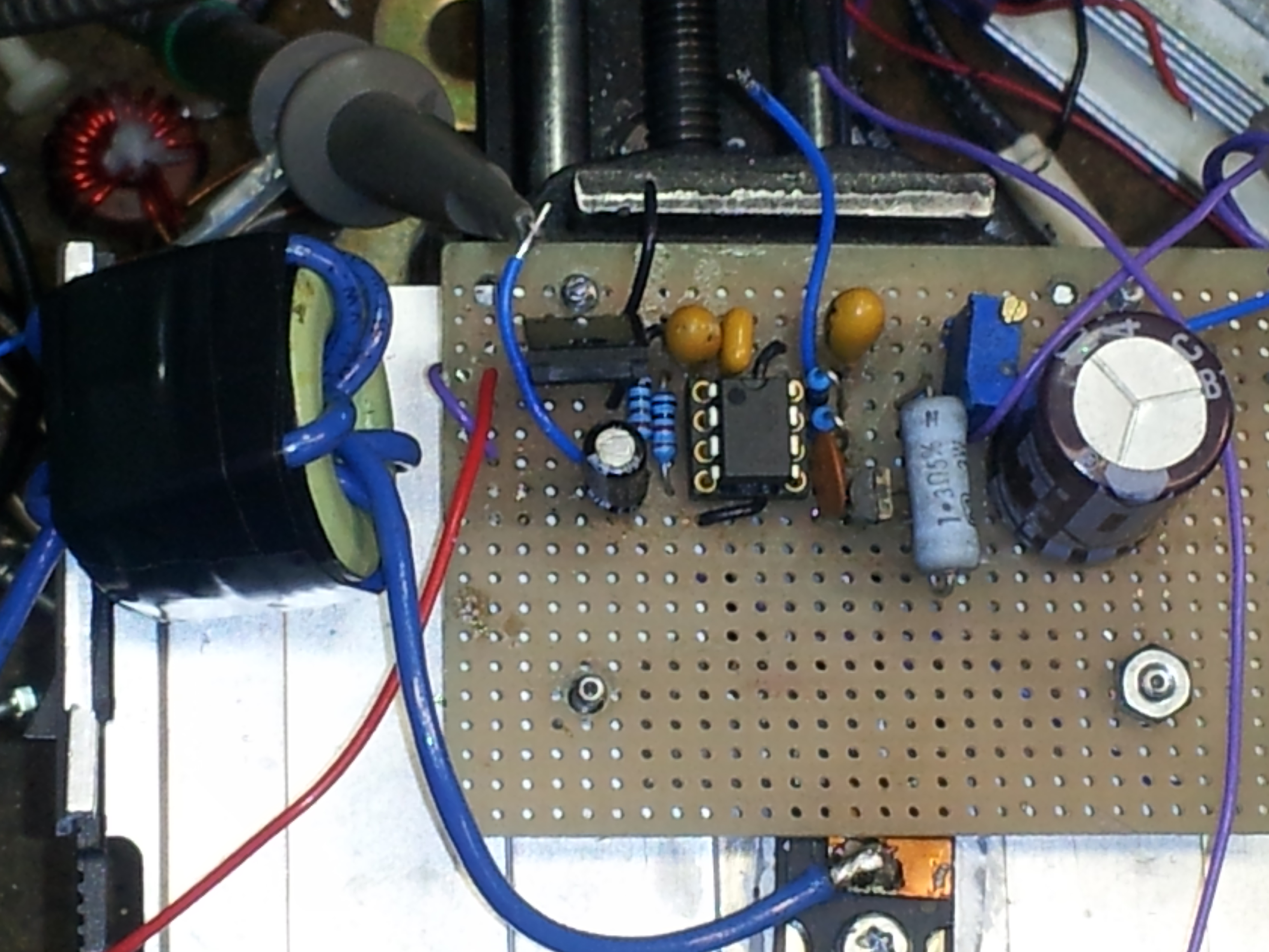

According LTSpice,this should work, I can get close, but no matter what I try, I have been unable to get much past 80 volt and 700 ma which then drops off around 5 - 600 ma after around 15 seconds as thing settle in. I tried several inductors and the last one had 2 toroid core with 6 turns and didn't seem to any better than the small one, but the FET did get hot enough for the solder to melt and turn the circuit off.
Does any one have any suggestions?

What parts are you using. D1 needs to be real fast!
You appear to be running at 300khz. That is quite fast.
You know there are real PWM ICs that do this job. A 555 is not built to drive a MOSFET gate at 300khz. I think the MOSFET is being turned on/off too slow because the 555 can not drive a large amount of capacitance. I think you have AC losses in the MOSFET that are too high.
Some of your parts do not work on my computer (pot and voltage regulator) so I shorted out the top two leads of the pot. I used 8 volts to run the 555. What voltage is the 555 running from?

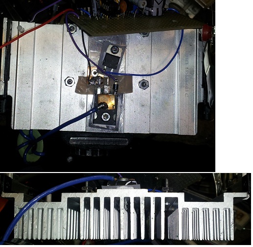

Heat sink on MOSFET???? Your current is high. Work out the DC loss in the MOSFET with the 6A current when things are running. It is high. During start up the current is 18A too much for that part. Your DC loss alone will kill the FET with out a big heat sink.

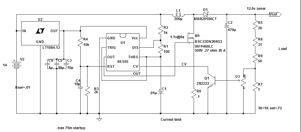

here's the corrected schematic with parts that should work with any LTSpice, the actual FET and Diode numbers are in blue.
As I tried it with a different number of turns, 5 to 8, the scope trace of current looked the same and the voltage and current through the LEDs remained about the same, less than a 10% change from 5 to 8 turns. The heat sink was large with lots of fins and a fan and the copper piece on the top of the fet was for heat dissipation of the drain lead and it still melted and let go, but didn't ruin the fet, as best I can tell and only let go as I got down to 5 turns, at which point I quit and opened this thread.
FET is a IRFP460LC 500V .27 ohm 20 A taken from server power supply
Diode is a STTH10R04D 400V - 10A from Digikey

Your diode is good.
You need a bigger FET.
With spice, when things are regulation you have 2V across the FET at 8A so the watts are BIG.
Frequency =375khz.
Try changing the 1.3 current sense resistor to much larger, maybe 13 ohms and get the thing running. Then work on getting more power.
In real life you need a capacitor across the input supply. 14 volts. It needs to be close to L2, M1.
You start up condition is very destructive. Now with out current limit the current goes very high. The FET has 8 volts across it at BIG current!
Look at TL284x. The TL2844 or TL2845 have a 50% duty cycle limit that is good for this application. This part is also known as USC3845 and many companies make it under slightly different names. The UC284x is a very old part. I first used it in PC power supplies for Samsung. It is most ofter used in off line supplies but it works very well for low voltage applications (14v). It likes to run in boost mode like you have.

Yea, it's hard to make 90 volts out of 12 with a standard boost converter. By the time you take into account the voltage drop across the FET, inductor and diode a duty cycle of 90% or so is needed. Usually most designs don't go over 60%. I can get it to run at about 65Khz with 100Uh inductor. But the ripple current in the output cap it way to high. I think its aggravated by the LED current going to 0 slightly below the 87 volt point. You can get rid of the big start up current by adding a .1 ohm in the source of the FET then a little current sense transistor that resets the 555.

I agree with RonV. There is too much boost.
Consider using the two LEDs in parallel. The boost will be 40 volts at twice the current.
To parallel the LEDs you need two current resistors. You started with a 1.3 ohm resistor so use two 1.3 ohm resistors, one for each LED. The transistor Q1 will need two 100 ohm base resistors.

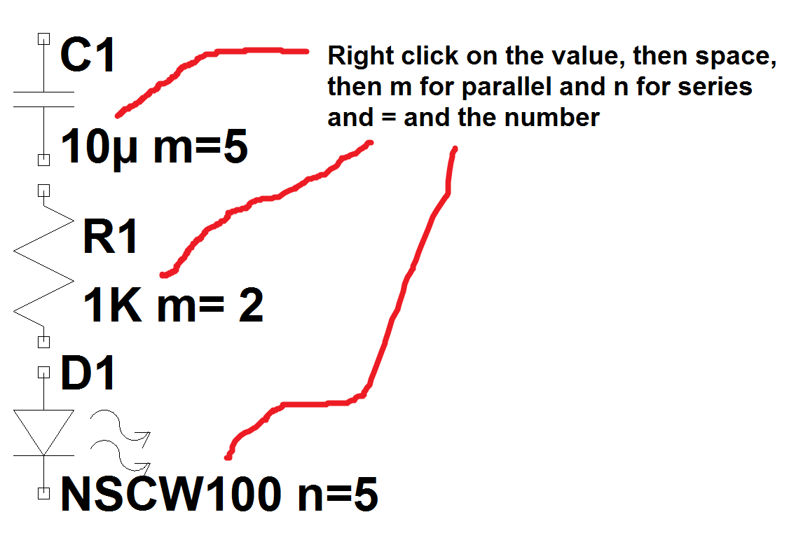

How did you get n=23 on the bottom LED and no n=1 on the top LED? I want to have n=17 on both.
If no n or m, one is assumed, I guess.

The two diodes in you 555 project; one diode is (1) and the other diode is (23 diodes). I can not change the n=23. I wanted to make both diodes have n=17 but I can't see how to do that. When I right click I can not change the n value, or add a n value.
_________________________________
Edited
I see, Don't click on the diode, Click on the name. It works now.

I picked a big inductor out of spice and changed frequency till I hit it.
I used 1.7 volts for the diode, 1.89 for the FET and .7 for the current sense resistor.
12.6v for the input and 87v @ 840ma for the output. I then set the nominal frequency and duty cycle for the 555 without the current limit or feedback from the LED current. Then adjusted LED current via POT and last set the current limit just above the required current.

I ran 7 amps through the FET, Vsg<10, and had a Vsd of 1.6V and 6.9A through the diode gave me a drop of 1.06 V.
Because of the heat generation, I found the use of an old hair dryer with it's 3 winding of 50,30, and 20 ohms very handy, especially with it's cooling fan.
