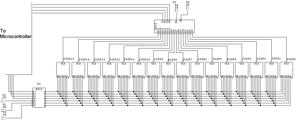

Another method
In the picture u will see another method.
I don't know it is new or it is already done by others.
May this work for u.
exprienced members plz check this circuit, it will work or not???
