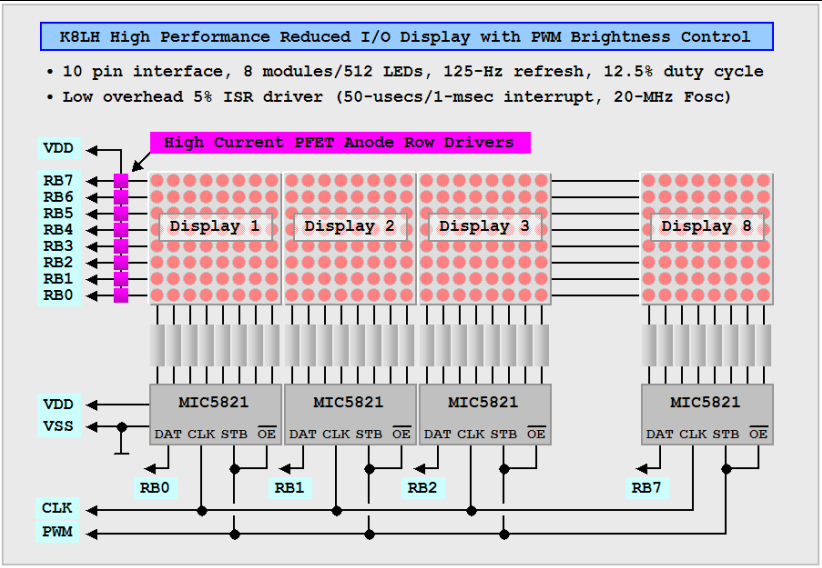

I want a shift register with 64/32 bits which have to be loaded parallely and shifted serially.please help me to find out the proper IC.:confused:
Why not just cascade some 8bit ones like the 74HC164, 4094, etc. I doubt you'll find a 64bit one.
kchriste's right, cascading multiple 8 bit devices is a simple sollution.
Take any eight 8 bit shift registers and connect the DAT pin on each one to a unique pin, for example RB0 through RB7. Throw eight bytes onto this 8 pin bus with a CLK pulse after each byte. The 1st byte should contain all of the bit 7 values, one bit for each shift register. The 2nd byte should contain all of the bit 6 values, one bit for each shift register. And so on through the 8th byte which contains all of the bit 0 values, one bit for each shift register.
I use a scheme similar to this to load up 64 bits for a matrix display "scan" cycle in about 4.8-usecs.

On re-reading your post I'm not sure my suggestion is what you're looking for. If that's the case, I apologize Sir.
