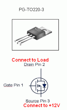

For Q1 i bought these https://www.digikey.com/product-detail/en/SPP15P10PL H/SPP15P10PL H-ND/2783608
and for q2 i'm using 2n3904
Cant seem to get it to work. Is R1 2.2K?
I'm seeing some voltage changes at q2 collector in response to changes at the base. But nothing from the q1. Sure i'm doing something wrong.
You understand that the PMOS is effectively connected upside down, with its source tied to +12V, and drain tied to the load:
And, if mounted on a grounded heatsink, you have to use an insulating kit to isolate the tab, which is also the middle pin, drain.
If you have the drain and source reversed, then the load will always be on, with the input having no effect.
I was looking at the datasheet and the posted diagram and realized about the upside down so Yes i have source pin 3 to 12v and drain pin 2 to load with the diode listed in the diagram to protect the spp15p10pl.
I just have the transistor plugged into a breadboard with no heatsink nor grounded heatsink. Right now the load is always off with no response to input.
Did you add an external diode across the PFET? The diode shown on the data sheet is built inside the PFET; no external diode should be wired across the PFET.
Wire a diode across the load being switched if it is inductive, like a motor, relay, or solenoid; diode cathode to PFET drain, and diode anode to Gnd.
In the diagram of post #2, the resistor from gate to source is 2.2K.

I'll check those voltages and edit. Load is a 85 ohm automotive relay.
My datasheet did not show an internal diode for the transistor i used listed above.
...My datasheet did not show an internal diode for the transistor i used listed above.
This makes no sense. I posted a fragment of the SPP15P10PL data sheet in post #24, and it plainly shows the PFET's internal diode, connected cathode to source, anode to drain. What transistor, and what diode are you talking about.
So, did you get it to work?
Yes! Got it working. Problem was both power supplies 5v and 12v were not sharing the same ground on the breadboard.
