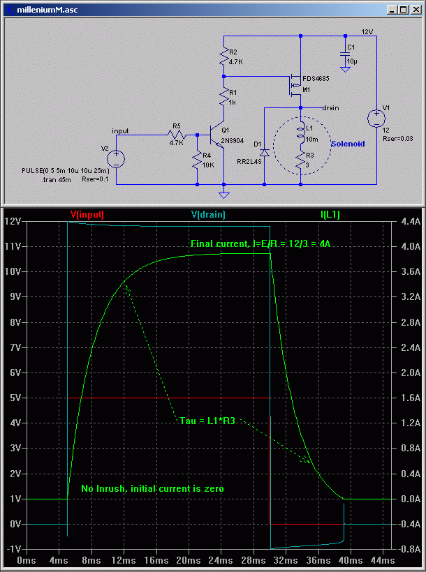

Please explain how there can be any inrush current into a solenoid with a finite inductance. I took your .asc file, modified it to closer reflect reality, and show both the turn-on and turn-off behavior of the solenoid driver. Note that I used much more realistic values for the solenoid inductance (~10mH, and its DC resistance = 3Ω. This makes the final current just under 4A, which is typical of an automotive door lock solenoid, for example.
I show the plot of current through the solenoid. Note that the initial current (right after the PFET turns on) is zero. The current approaches its steady-state value of ~4A, and it takes ~3 time-constants = L1*R3 to get there. Note that the settling time is consistent with what you would actually measure in a solenoid of this type...
When the PFET turns off at time=30ms, note that because of the snubber diode, the decaying current through L1 is well behaved, with the same time-constant. Note how D1 clamps the drain voltage V(drain) at one diode drop below ground (-0.7V) until the solenoid current stops flowing.
..with many solenoids, the core is the "contactor", and it contacts by getting pulled into the windings, when the windings are energised with current........at first the "plunger" is outside the windings, and so the windings have just air inside them, its only when the (high permeability) plunger pulls into the windings that the permeability of the plunger is then in the windings to give that bigger inductance.
I think a lot of solonoids are purposely built with too-high resistance just to mitigate inrush, and this then means that they waste loads of power..its a great shame when you think all that's needed is a bit of inrush protection..take solenoid valves in electric showers.....they dissipate something like 10 watts just in the coil resistance...totally unnecessary....I can hear the regulators moving in...blue angel etc
Dang Mike, your still awesome. Long live the Saturn III. :)
That is what happens to inductance vs plunger position, but your conclusion about what effect that has on the current in the coil is wrong. The position of the plunger effects the inductance of the coil, in a highly non-linear way, with the initial inductance low, and the final (gap closed) inductance several times higher, but the resistance of the winding does not change. The inductance would be proportional to 1/(remaining gap).
If you assume that the initial inductance is zero, then the coil current would would be entirely determined by the coil resistance. If you wait a while, the Ldi/dt term (whatever L is) goes to zero, and the current is again entirely determined by the coil resistance (with no change between initial current and final current). There is no "in-rush"!
