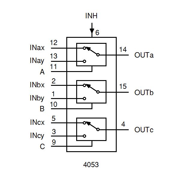

so with my attached image would this be correct for the 4053 IC?:
- 11 goes to PIC pin.
- 10 goes to PIC pin.
- 9 goes to PIC pin.
- 12 would be the 5vdc IN.
- 2 would be the 5vdc IN.
- 5 would be the 5vdc IN.
- 13 would be the 12vdc IN.
- 1 would be the 12vdc IN.
- 3 would be the 12vdc IN.
- 14 would be either 5 or 12vdc OUTPUT depending on PIC pin signal.
- 15 would be either 5 or 12vdc OUTPUT depending on PIC pin signal.
- 4 would be either 5 or 12vdc OUTPUT depending on PIC pin signal.
that correct?

maybe you didn't read AK's response ??
The 4053, or any other standard CD4xxx multiplexer, will not work in this application. Two things. First, the absolute minimum ON resistance is 125 ohms. To push 1/4 amp through that would take over 31 volts. With a 12 V source, the short circuit current at the output would be less than 1/10 amp. Second, the absolute max current in any pin is 10 mA.
per
the
datasheet
ak

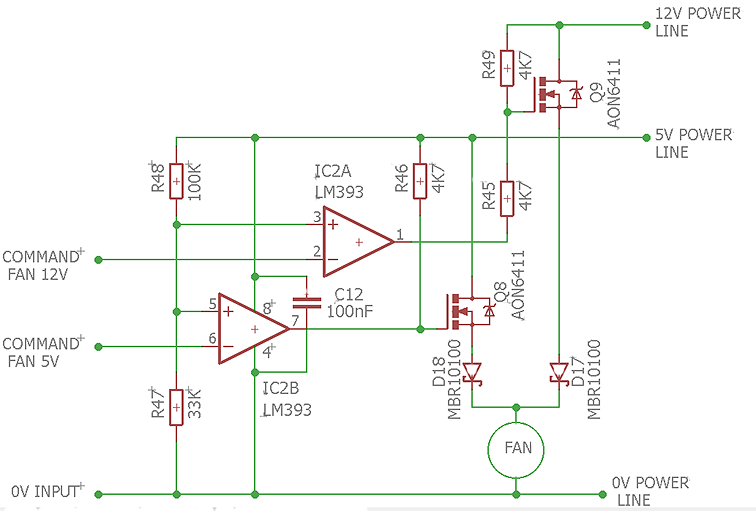

The circuit below gives an idea of the type of circuit I am thinking about to control the fans.
On the other hand, you could use pulse width modulation and just the 12V supply. In that case only a single control line would be required from the microcontroller. and the circuit would be reduced to about four components.

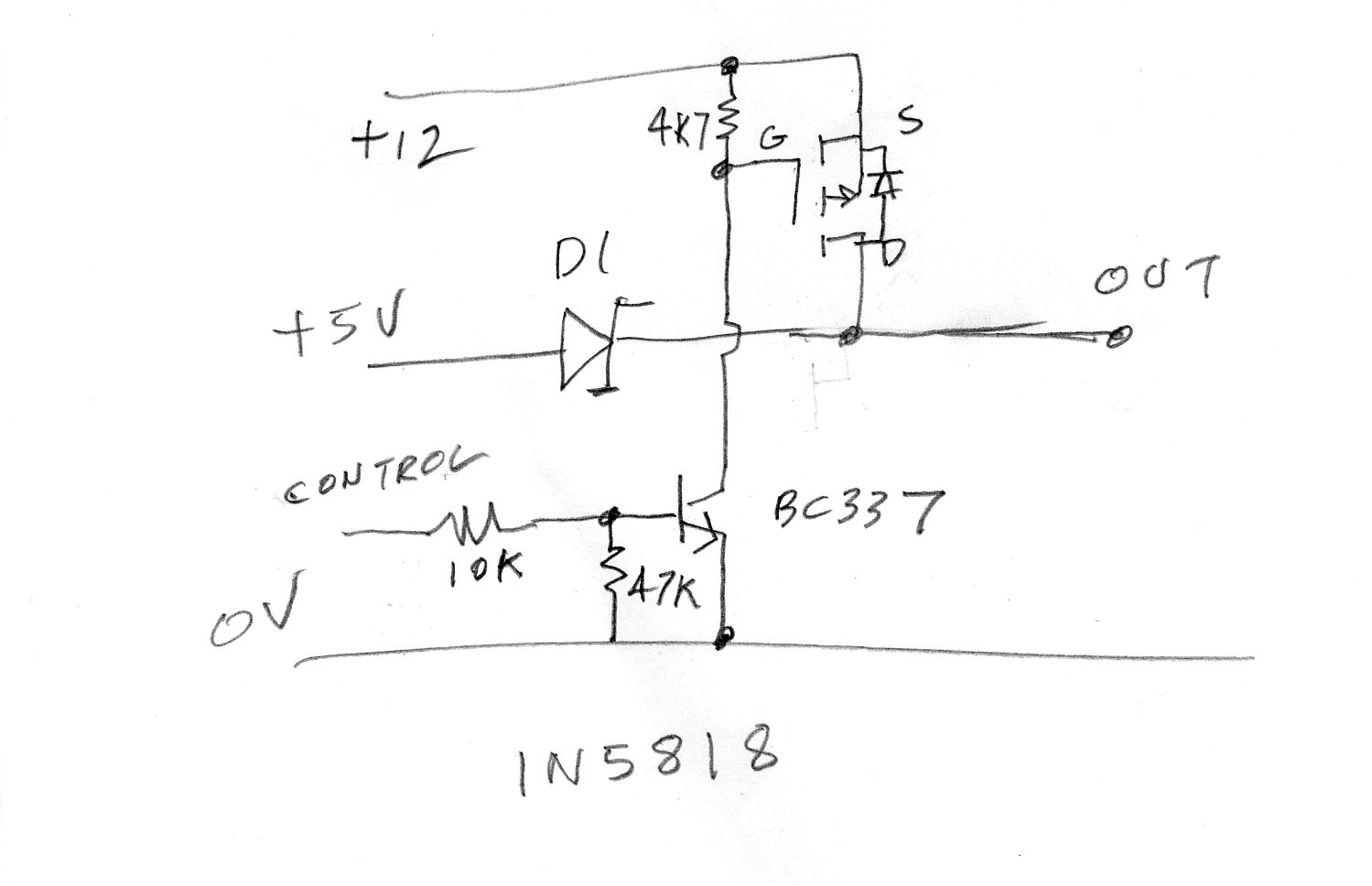

This is another suggestion using discreet components.
This is one changeover switch function. I suggest a schottky diode such as a 1N5818 and a P channel mosfet such as an NDS356. The diode would have a forward voltage drop of about 0.5 volts So the out put when 5 volts was selected would only be about 4.5 volts. A high level on the control input selects 12 volts output.
Les.
Yeah, I thought about a diode but didn't like the Vf loss. 5 V fans, and 12 V fans running on 5 V, aren't all that reliable to start with.
Les.
Very neat Les: shows lateral thinking.
There is just one thing though: your circuit does assume that the fan will always be on. I wonder if the OP wanted to turn the fan off as well.:)
If you chose a hefty Schottky diode, say the ubiquitous MBR10100, the voltage drop will not be that significant. https://www.onsemi.com/pub_link/Collateral/MBR1080-D.PDF
May I make a small suggestion, why not make the BJT an NMOSFET and save two resistors?:)

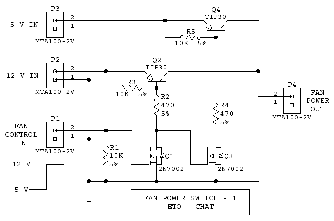

All discrete approach, first pass.
ak
Another nice approach AK, and also a well presented schematic.:cool:
The way that you have catered for the reverse connection of the 5V switching BJT is neat, but is it within the BJT data sheet limits? I am just interested, because it is a situation I have pondered about a few times in the past and can't come to a firm conclusion.
The use of MOSFETS is a good idea, but the 2N7002 has rather a high worst-case gate threshold if you had a 3.3V system controlling the fan voltage. There are NMOSFETs with lower worst case gate thresholds. **broken link removed**
I only make these points out of interest.:)

Hi spec,
You make two very good points. I was being lazy. I use the 1N581x series schottky diodes when I build boards with PICs so that the ISCP programming connector does not try to power the rest of the circuit. I have a stock of BC337s so I just picked that number and the P channel MOSFET is a type I had just added to a recent Farnell order to make up the price to get free postage. It looked a useful device. It is an SMD device so that may not suit the OP. There does not seem to be many P channel mosfets with a low RDSON resistance in a TO-92 package.
Les.
Hi spec,
