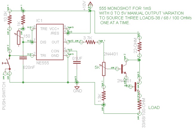

I've produced a design much as circuitspecialists describes but am presently unable to upload it because of the site's problems.
Can you sent it to my mail
One more point
{Don't worry about 0.5V steps, 0-5V continuous variation is required by manual turning of POT and the pulse at load is monitored for amplitudes set at 0,0.5,1,1.5,2,2.5,3,3.5,4,4.5, &5 volts.}
modified design
Pls find the modified schematic.....Is it OK ?
Can I produce the low values like 0, 0.5, & 1.0 V by turning 5K ? (also 1.5, 2.0, 2.5, 3V medium values & 3.5, 4, 4.5, 5V high values at output of darlington)

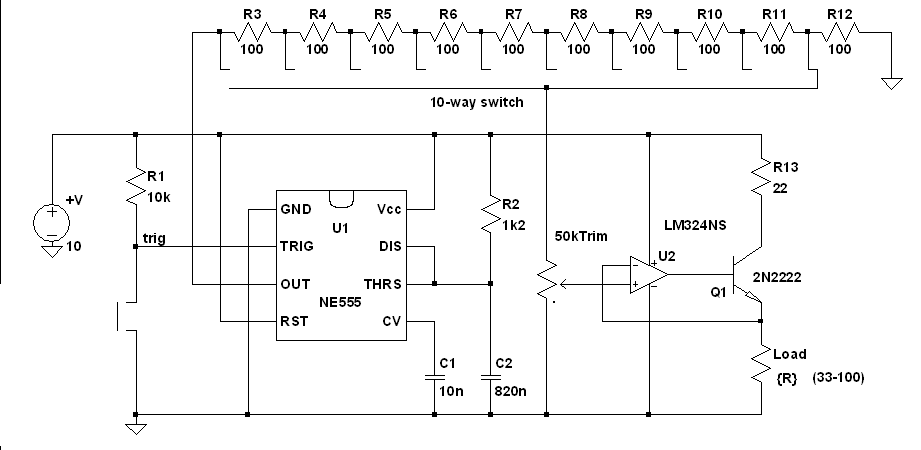

That should work ok, although there will be a slight (~5%) variation in voltage across the load as the load changes.
Here's the schematic I mentioned:

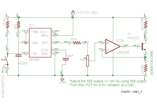

555-opamp-bjt
555-OPAMP-BJT
Here is 555 oneshot with LM324 & 2N2222 for 0-5V continuous amplitude variation of 1ms pulse.:)
Any rectifications ?
That should work for a 10V supply. For a lower or higher supply voltage reduce or increase, respectively, the value of the series resistor.

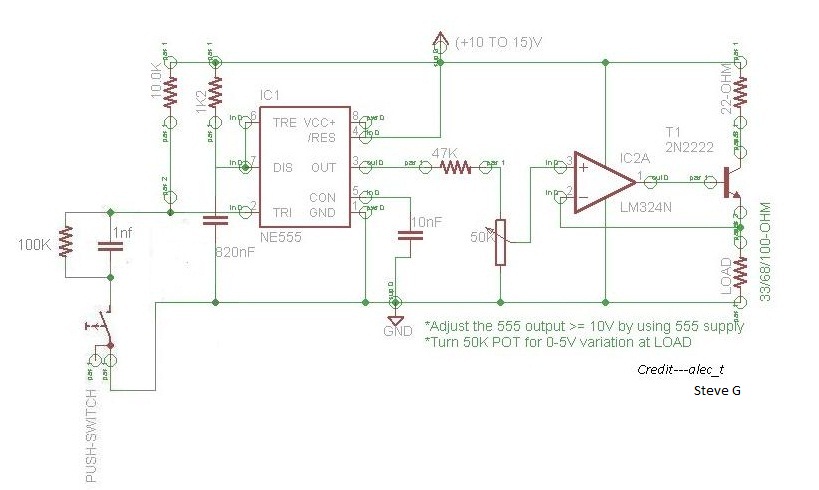

Problem continues....
The following are the difficulties I have faced during the above circuit implementation,
1. 1ms pulse by pressing the trigger micro switch is hard to achieve as it depends on the duration of pressing the switch and is beyond 1ms (depends on the operating person)
2. To overcome the above difficulty I have designed one 3ms 555 astable and is fed to monoshot through Differentiator
3. In the 2nd case I cannot control the count of mono pulses at output as I only want a SINGLE 1ms pulse at 555 mono out.
:confused:
The issue is that the trigger pulse is longer than the time out period, ie 1ms.
With it being such a short period a cap in series with the trigger switch might be impractical so I'd be inclined to arrange a circuit on the o/p of the timer that disables the trigger, ie make the timer non retriggerable until the switch is released.

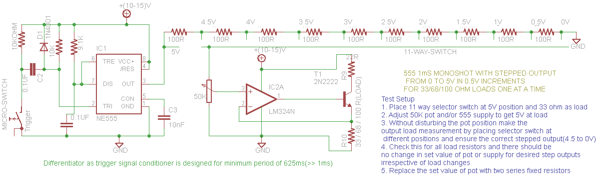

optimized schematic
optimized schematic to overcome above mentioned difficulties..:)
The 50k will be in parallel with from 1 to 10 of the 100Ω resistors, depending on the position of the 10-way switch. The maximum linearity error (assuming the resistor tolerance is <<1%) will be about 2% when the switch is at position '9' with the 50k bridging 900Ω. If that is too high you could replace each fixed resistor with a multi-turn high-stability (i.e expensive) trimmer (say 150Ω) and calibrate the system.
The maximum linearity error will be about 2%
Can I replenish this voltage drop due to the addition of 50K parallel by adjusting the 555 output above 5V through supply voltage variation ?
1. put switch at left side of R3 and adjust the 555 output through supply voltage variation for exact 5V across 50K pot
2. Do not disturb the above supply adjustment. We will get 4.5, 4, 3.5,.......etc at all other positions for this setup.
3. 0% linearity error:)
No. That would have a similar effect to adjusting the trimmer. It would vary the load current for all switch positions.
Edit: Increasing the value of the 50k trimmer to 100k would reduce the loading effect on the resistor ladder, but the input impedance/current of the opamp might then have a more noticeable error-producing effect. Just how accurate do you REALLY need the load current to be?
