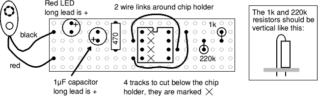

this is the project i am working on

Did you cut the tracks where the instructions said? Use a meter to confirm there is no stray copper.
The 555 is wired as an astable multivibrator.
Check the connection of 1uf capacitor and its polarity.Or try changing the capacitor.

first you put the actual circuit diagram you are working with. And check the frequency of your astable multivibrator. May be its too big that you can not see the blinking...
as your circuit diagram shows, your 555 timer IC is working in astable mode...to see the clear output keep your output frequency in KHz range.
