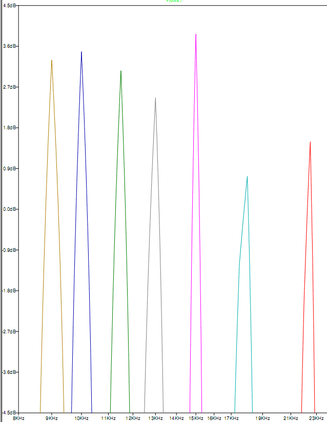

amp selection aside, I've reworked the SPICE schematic and I seem to be getting good results without any op amp. The other things I've changed is the transistor to a 4403, which I have, and modeled the line-out connections and DCoffset as applied through a voltage divider. Also, I'm stepping the Rsense down to 10Meg, because it turns out the sensors have >5Meg at rest. So their response is rather nonlinear until 5Meg, then is pretty consistent between 5Meg and 2Meg. So, there's no output signal at all at rest... but this shouldn't really matter because it will still be providing the correct range of frequencies in the range of force with which i'm concerned. If I need to change this, I can just add a 5Meg resistor in parallel with the Rsense and adjust the 555's tuning as need be.
Is there any reason I should not use this configuration, that is, without an op amp? It seems that including an op amp is getting me slightly more bandwidth in the range of response frequencies... is that the only reason to include an amp? Sorry for questions that are probably basic electronics theory. I really just hobby in electronics and volunteered to do this project out of interest.
fyi, the attached graphic shows the output frequency when stepping Rsense from 2Meg to 10Meg ohm in 1Meg steps. 2Meg produces the faster frequencies.

IMHO, that is a terrible design, from an engineering standpoint. The transistor collector current determines the frequency. The collector current is beta times the base current. The base current is (Vcc-Vbe)/Rsense, which is fairly stable. However, beta varies widely from one transistor to the next, even within the same part number. Morever, beta varies with temperature. The op amp circuit is designed to minimize the effects of these variations.
