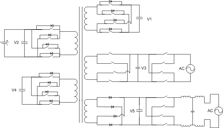

I am designing a device that combines multiple different functions into one device. It will be primarilly a combination battery charger and regenerative motor controller, but I will add a pure sine wave inverter on if I can.
At the heart of the device will be a multi-directional DC-DC converter. I am planning to use a push-pull Flyback Converter to keep the different areas electrically isolated. I need for power to be able to flow in just about any direction to/from 5 different DC stages.
I wish to check my reasoning on how this will work:
Each DC stage will have a fixed nominal DC voltage. The ratios of the windings in the transformer will match the desired DC stage voltage. The size of the wiring and transformer core will be sized for the max desired average energy transfer.
When a DC stage is transferring energy out it will turn on the transistors and send a current pulse through the transformer. Flux will rise in the core and when the pulse turns off that flux will rapidly ramp up the voltage across the other cores until the diodes in one of the other stages become forward biased and current will flow in that coil only, charging the capacitor in that DC stage only utill the flux drops back to zero.
My theory is that whichever DC stage is transferring power out will be lowering the voltage on its capacitor only and when another pulse goes through the transformer it will be the only stage to charge. I am hoping that I do not need any other mechanisim to direct the flow of energy: One stage pulls energy out and one stage pushes energy in. The energy will flow properly controlled solely by the relative DC voltages of each stage. Am I right?
I have full bridges on everything so I can alternate pulses and not saturate the core. I also hope to be able to use the transistors as ideal diodes to increase efficiency. I am also wondering if I can add a small low power, low voltage winding around the core that is tied straight to a resister. What can I learn if I monitor the voltage on that resister? Can I measure energy transferred? Core saturation?
I plan to control each stage with its own microcontroller with one master controller taking care of all of the main switching through optical isolation.
I think ATX power supplies do something similar, using multiple secondary windings to feed different voltages. Am I correct?
Thanks in advance for your feedback.
-- Paul

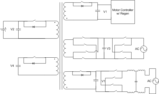

yes...and no. Flybacks are not push-pull and naturally cross regulate.
That said, there is no such thing as an ideal transformer. Flybacks charge the primary inductance and the energy is transfered to whichever winding has the lowest volts/turn on it. Saturation is determined entirely by peak primary current.
Dan

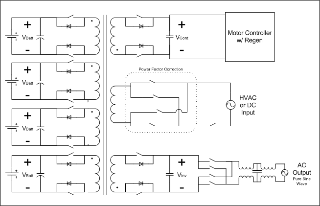

So reversing the pulses won't really gain anything? If so I can eliminate the H-bridge of the biggest power stages and run each with one transister. (see attached) I'd still need an H-bridge on the Rectifier as I want to be able to transfer power to the motor directly from the rectifier if I run with a generator. Also I want to feed the inverter from the rectifier for an optional power conditioner / UPS function.
Do I even need the DC stage on the rectifier? I want PFC so I'm chopping the 60 Hz AC. Can I just feed that into the transformer directly? If so I need some protection so the pulses from the transformer can't feed back into the AC line when the 60 Hz is near zero.
The single capacitor stage is for an ultra capacitor bank for the motor regen.
Thanks again for any input!
-- Paul

you are trying to run at 60Hz? normally something like this would be a full wave bridge into a 60KHz boost PFC running the motor directly and the isolated supplies running off of that as well unless someone got real clever and did custom magnetics to tap power off the boost inductor.
Dan

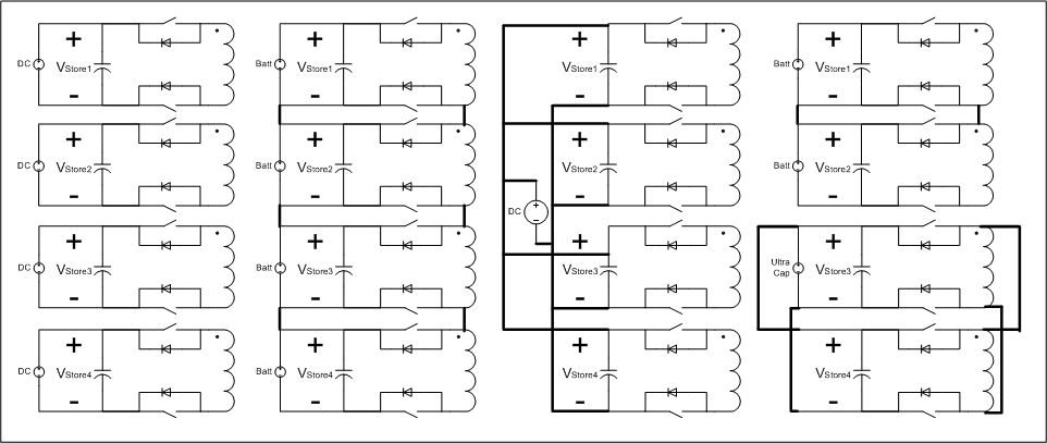

Now that we agree it is feasible legally, what about electrically?
I've attached the latest design. Would IGBTs or FETs work better? I put two in each circuit so I can keep current from flowing either way if I need to. I would like to use the FETs as ideal diodes if I can.
I've read that some optocouplers can generate enough voltage to turn on a FET without any additional power. Is this so? If so I am surprised no one has built a power FET with an optically isolated gate built in.
I want to be able to transfer 1000W continuously. That would be all of the different combinations of power transfer added together. I'd like to be able to push 3 times that for 10 seconds or so, for acceleration or regen braking. If I figure 12V nominal for the battery (13-14V most of the time) that would be about 80A continuous draw from the battery. What max pulse current should I plan for the FETs on the battery?
The motor controller stage and AC stages will have much less current. If I want 240VAC out for the Inverter I need about 350V there and the motor controller should be about that voltage as well. 5 A continuous is plenty there. I'd like the universal AC/DC input to work down to about 80 V, so 15A continuous there should work.

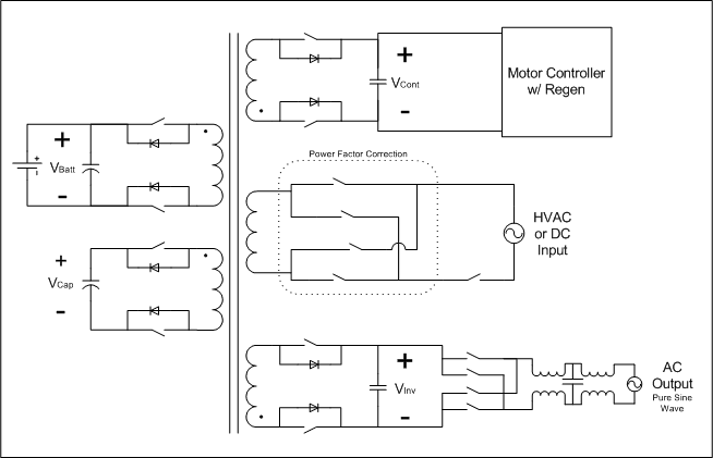

The Ultracapacitor is an issue. Max voltage on a single Ultracap is low, 2-3V or so. I don't want to stack several together because I don't want too much capacity on any one controller, I want it spread out. I don't need a lot of capacity, just enough to dump 2 or 3 times the amount of energy a 2 ton vehicle has traveling at 60 MPH. If I need to dump more than that, say coasting down a mountain, then I would dump energy into the batteries. After all, that's where the power to climb the mountain must have come from, right?
Would it be better to tie the ultracap directly to the DC stage of the motor controller? That would be about a 100:1 boost/buck ratio. I need a very low voltage drop when charging or discharging the ultracap. Efficiency isn't as key as with other parts since we are trying to recovery energy that would be wasted anyway. If we loose 30%, we still save 70%. If I want to be able to move 3000W+, it would be over 1000A. I just looked it up and the max current for a large ultracap is about 500A, so I can't dump as much energy as I want unless I stack at least two cells. Hmmm, this will require more research...
The benefit of using ultracaps is to be able to recover more braking energy that charging batteries alone can do and to reduce max draw on batteries while accelerating. It seemed logical to add an ultracap to each slave controller. Perhaps it would be better to just stack 5 or so ultracaps together in a string and attach the 5 slave controllers to the stack in parallel. Then each controller would have 10-15V to work with and they would divide the 500A or so between them. I’m gonna look into this more…
Overall, is there any major flaw I am overlooking?
Thanks,
Paul

Wow, Ultracaps nope. You'd need a truckfull of em.
Here's some math to help you calculate how much energy you need.
Although this is not an HHO thread here's more info on just how much power it takes to move a ton of car https://www.aardvark.co.nz/hho_scam.shtmlhttps://www.aardvark.co.nz/hho_fraud.shtml
Also remember adding batteries / anything will increase the weight of the vehicle making it require even more power.
Ultracaps for Regen only

I don't want to run the car on ultracaps full time. Just for the burst of energy at acceleration and to store the energy from stopping. I found these supercaps online. Fully charged each one would hold about 8,000 J, or 8 Killowatt-seconds. Put 5 together and I'd have 13.5 V, 440 F capacitor capable of storing 40 KW-S.
If I have 5 slave controllers using that capacitor bank in parallel, then each could pull about 250A, or about 3KW with a fully charge capacitor. Basically that $100 or so cap bank shared between 5 controllers would allow for the controller to pull max current for the initial acceleration. As the capacitor discharges the batteries take over for long term load. That is the basic idea for a simple regen system. It would extend battery life while simultaneously increasing range and performance.

Thank you very much for the real life experience. I’ve readjusted my thinking a little and I’ve attached the latest version I’ve come up with. I’ve decided to beef up a basic slave from 1000W continuous to 3000W continuous, or 4 HP. Figure 10 HP or 7500W peak for 30 seconds. I figured there was no real world situation where someone would want a single slave, not even for a motorbike or golf cart. A 4HP controller is a more reasonable minimum size and it still allows the system to be expanded one controller at a time until desired power is reached.
I designed it to support 4 separate DC storage devices. I want to be able to use batteries or ultracaps (or hampsters on wheels! Whatever.) The 4 DC storage inputs are isolated, but they can be connected together as needed. I’ve attached a few examples as well. First, 4 isolated batteries. Next a string of 4 batteries connected in series; the coils on the transformer would be jumpered in series too. Then in normal operation only the FETs on the outside of the string would be turned on and current will flow through all of the coils with minimum voltage drop. Each battery, or string of 2 or string of 3 can be used individually as well, allowing the system to maintain each battery at optimum level and load. Another option is all 4 inputs connected in parallel on one source. That allows for 4 times the power transfer, say for an ultracapacitor bank. The last option is a compromise with a string of two batteries and an ultracap bank using two in parallel. The best of both worlds as it were.
So let me run through a basic sanity check as you have suggested:
Cost effective? If I leave out the inverter that most EVs do not have and look at just the charger, controller and battery management system I find that it would cost over $6000 for a system that can support about 30 HP continuous load. Could I produce one master controller and 8 slaves for less than $6000? Maybe $1200 for a master and $600 for a slave? Millipack PMAC controllers cost less than $500 and produce more power than I’m aiming for. That’s with all the brains in the controller where my slaves will have a central control and so less complex control. I think I can keep the costs in line with other options. My system will have much more capability of course, making it all the more attractive.
Difficult to make? For me to make by myself in my garage? Too difficult for a full blown prototype, but some parts could be proven out. For me to build in cooperation with a small electronics manufacturing firm? Not overly difficult. The only part that isn’t off of the shelf is the transformer. It would need to be specially made. Cost would be high for small production runs, but it would come down a lot if it were produced in volume. One of the reasons I want it to be usable for multiple areas with only programming changes is to reduce cost with volume.
How long to see cost savings? A very, Very long time. No way this makes sense for me to build in my garage and avoid buying off of the shelf. This only makes sense if it gets manufactured.
How Practical to operate? Very, once it is finally produced.
I think the idea is worth pursuing. At the moment I just want to refine the idea and get some feedback.
