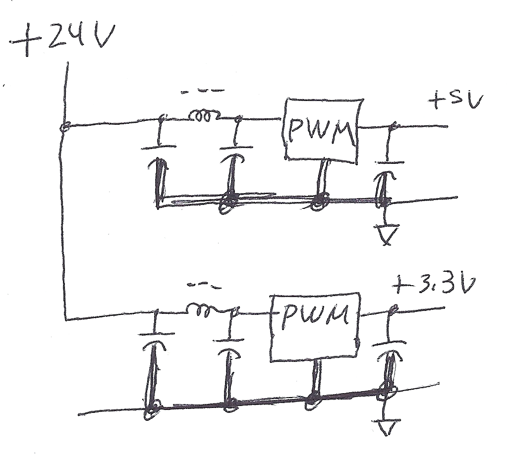

I am designing a PCB that will distribute power to various loads. I have thus far designed it to have five switching regulators. It has come to my attention I should worry about synchronization of the switching pulses. To that I suggested I design each power supply with a different frequency. I was told it seems like an ok approach off hand, but to look into related harmonics. Such as if the fifth or sixth harmonics are related between the various regulators. All regulators are identical part number, and the rest of each power circuit will be identical too except for the switching frequencies and current limit resistors.
How can I start to look into the harmonics of a particular buck regulator or design incorporating one. I am in the design phase.

I also missed you saying that your regulator was the Vishay SIC461. No built-in frequency synch...that's going to be a PITA to make it synch. It might even be impossible. I don't see a way to access the clock.
The part you have chosen has a constant on time, so it is more like pulse position modulation than pulse width modulation. As such, it does not lend itself to external frequency synchronization. Also, the noise signature varies as a function of load current, a particularly nasty filtering problem. Vicor DC/DC converters have a similar "feature".

I have used 5 PWM on the same PCB.
Here is an idea: There are two places where the 5V and the 3.3V regulator can talk to each other. Ground and +24V.
1) I show heavy traces in the grounds of each PWM. Then this ground connects to the ground plane in one place. Ground currents from cap to PWM do not flow in the ground plane.
2) Use a CLC filter to brake up the 24V into little pieces. Current in the PWM needs to come from the capacitor at the PWM and not from the 24V.
