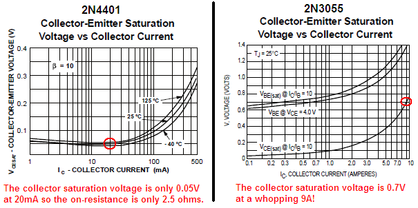

No.
An ordinary little transistor like the 2N4401 has a collector saturation voltage of only 0.05V at 20mA, not 0.7V.
Maybe you were thinking of a huge 2N3055 power transistor at 9A.

Very true, but still more than double the drop of a BS170 under the given conditions.
So, 'scuse my ignorance again but, on small circuits with very few 'voltage drop' components, a bipolar transistor would be ok, but when the circuit it large and therefore the total cumulative voltage drop is large, a mosfet is preferable? Is that about right?

Each (unwanted) voltage drop in a circuit requires power.
In the example given the bipolar transistor dissipates 0.001W (1mW) while the MosFet transistor dissipates 0.00048W (480µW).
You decide which one you use to preserve energy.
