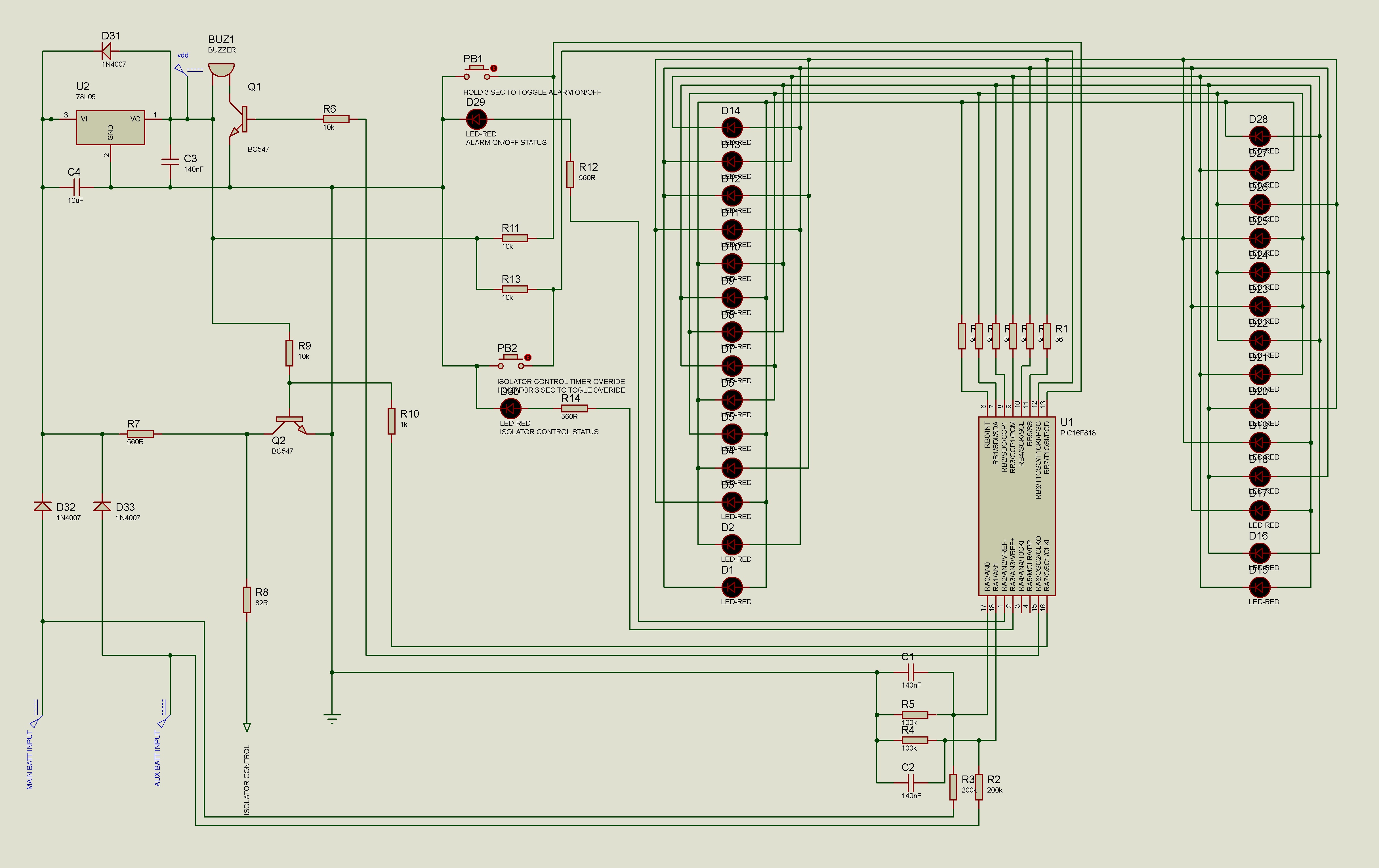

Hi everyone,
So I'm trying to program a replacement pic16f818 to operate a dual battery monitor but as this is my first ever pic project I'm having some difficulty.
I'v attached the Schematic which uses Charlieplexing for the led indicators and the code I have so far.
The problems I'm facing right now are the code is too large for the pic and I don't know how to reduce it and also the ADC doesn't operate on both channels.
If I comment out the code for one channel the other will work.
any help here would be much appreciated.
Thanks.

I can give you a hint on the a/d, however there shoudl be enough room in the pic for that code, is the compiler setup right?
As for the a/d, you switch the i/p to the a/d then do a conversion immediately, if you look at the pic datasheet there is an aquisition time, you need t wait for a period after you change the a/d channel before a conversion, try the 1ms you've been using after selecting the i/p.
Thanks Dr Pepper
I uninstalled then reinstalled xc8 then added the delay before ADCON and its now compiling the full code and working on both channels.
Your help is greatly appreciated.
