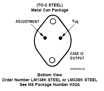

Hrmmmmm, I'm wondering if I mis-read the pinout on the LM338... looking at this:
what pins are A, B, and C?
I didn't initially see that it said "top view" on the left part, and so I assumed the view was from (what I call) the bottom; the part where you can see the insulating rings around the pins as shown in the diagram. If you look at it from the (much clearer) 3D view on the right, what do pins A, B, and C -- my markup -- correspond to? I have it wired with A as Input (2) and B as Adjust (1). C is quite unambiguous, and I have it wired as the Output (3). Do I have a different idea of what the "top" of the TO-3 is (and thus am reading it correctly) or are they essentially showing an x-ray view through the can? :p
I wired it up and plugged it in for about 10-15 seconds, with ~53VDC in; it never got hot or smoked or anything, but the output pin read dead 0.0mV. Also of note, I did briefly short the output to ground as I was trying to get my leads on the connectors -- I bumped the ground alligator clip and it snapped to the next tooth, allowing it to touch the output pin. I very quickly rectified this, but, assuming I have the LM338 wired correctly, would this have permanently killed the 338?
If I did get it backwards, would the LM338 be fried from this, or would some sort of internal protection just shut it off, so that rewiring it correctly would resolve the problem? I don't want to rewire it yet in case I do have it correct, and I'd rather not have to dremel out the mounting holes in the board to accommodate reversal of the TO-3 -- especially if I do have it right currently.

Here's a better picture of the case.
I'm not sure if swapping the input and adjust pin will damage it, a quick glance at the LM338 schematic tells me that it might be all right.
Shorting the output to 0V when the input it >40V can fry an LM338 because the maximum input-output voltage is 40V. If you need short circuit protection then I know of a circuit which should work.

it's backwards :eek:
the stupid datasheet picture is like an x-ray view, and thus indeed from the top.

Have you got it working now?
Yes, I wired it up shortly after I posted (right before I had to go to work) and got it working :)
