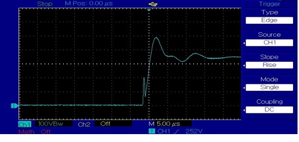

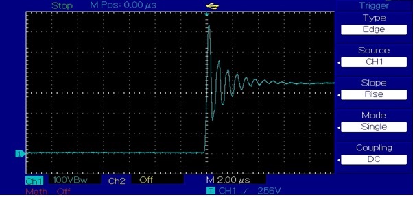

We are using a 450V rated LR8 linear regulator in our offline product. If the product happens to get switched on at mains peak then the LR8 gets a voltage of 600V peak at its input (as in the scope shot attached).
However, if we put a 100nF X2 capacitor across live/neutral, then the peak voltage applied to the LR8 is 500V. …However, the peak duration is longer even though its less voltage (as shown in attached scope shot).
Which is less harmful to the LR8?

The higher voltage is likely more damaging, buth either could zap the device.
Why don't you add a transient suppression diode (TVS) to protect the device?
Or use a zero-crossing start-up circuit?

Is this the kind of thing you can solve by putting an RC snubber at the input (well, I guess you putting a cap across it it very similar)? It looks like it, but I've never heard of an RC snubber being used for something like startup ringing. What would cause that behaviour?
How much current are you drawing from the regulators output?
If it's small, you might consider adding a resistor in series with that 100nF X2 cap to slow it's rise time. And probably get rid of the spike entirely.
