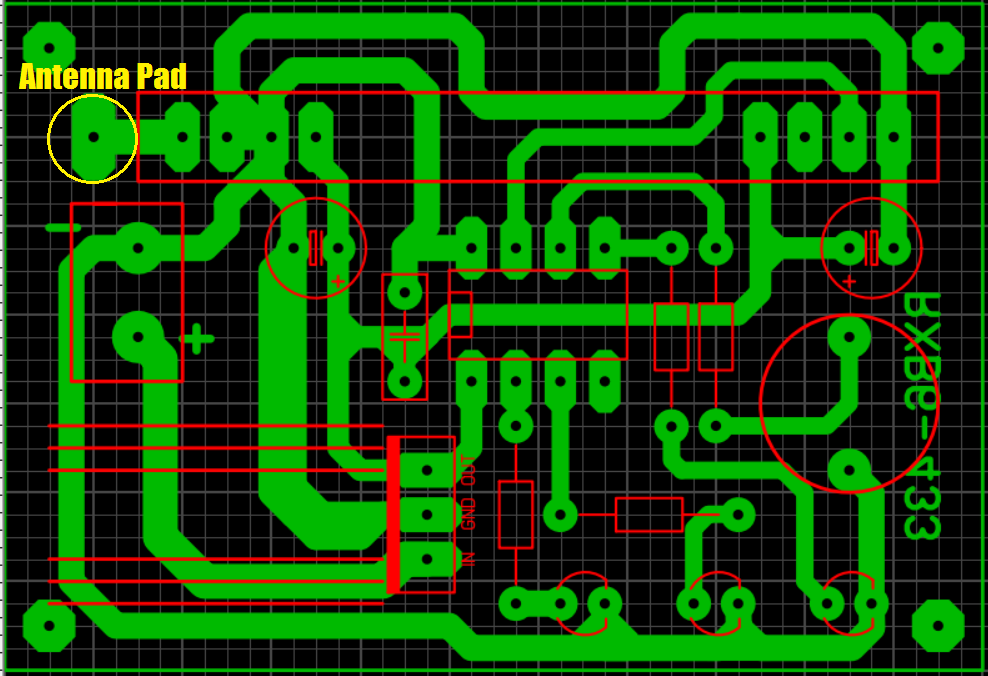

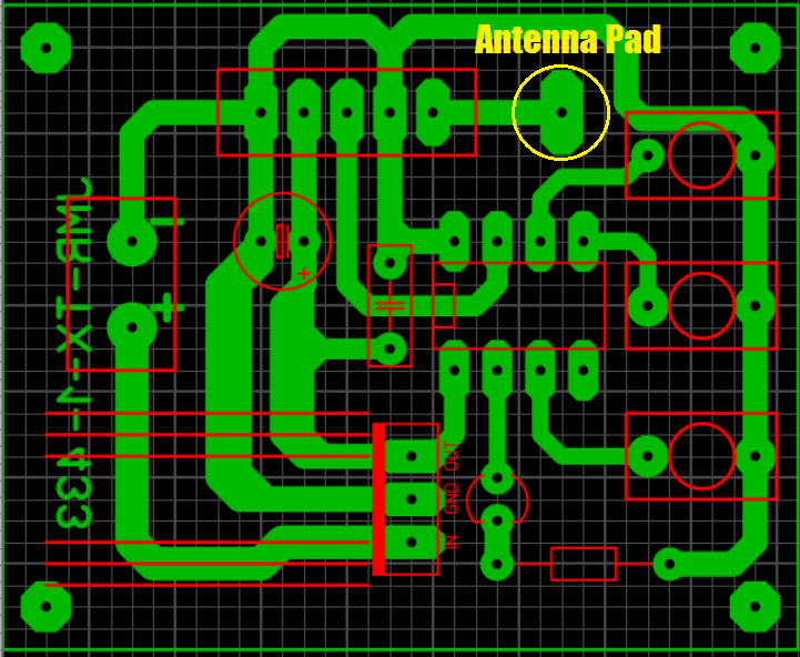

The answer depends on where the module is mounted on your board, how you will connect the ANT terminal of the module to your board, and where you plan to locate the wire antenna connection point on your board. Can you provide a drawing?
Hi, I the attached PCB layouts of both RX and TX which the ebay 433Mhz modules going to hook up.
The ebay 433Mhz modules have header pins & I directly insert the modules to my PCB & going to solder.Even the antenna has a header pin.The antenna I'm going to place on my PCB showed label "Antenna PAD".

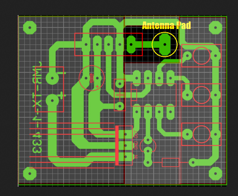

OK. I recommend that you include a ground plane as shown in the attached figure. The ground plane is the area that has a grey tone to it. It is under everything except the antenna trace. This assumes your antenna sticks straight up from the pcb (perpendicular to the surface of the pcb.
Thank you very much.That is transmitter PCB & I'll add a groundplane as you suggest.What about reciever side do I need a groundplane to that as well...!!
Yes, the RX board will need a ground plane also. It should be designed using the same principle as the tx board. By that, I mean that the ground plane should cover all the board except under and close to the ANT trace.

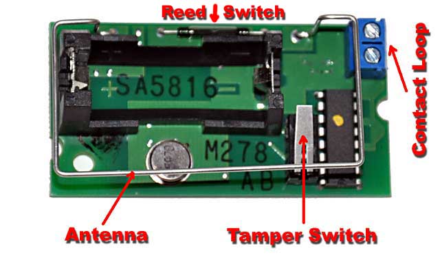

My target is to build a reliable wireless transmitter & reciever which can work about 60-70meters.please note that the transmitter must be place inside a professional looking small enclosure.so the antenna must design to fit it.
I want something like honeywell 5816 transmitter where the antenna is placed inside the enclosure horizontally and it is working 200feet from a 3V battery.
Actually my modules are 315mhz.can i build a link like honeywell design from these ebay modules?
If you plan to put the transmitter board inside a box, then we should ask the question...what is the box made of? If it is metal, then the portion of the antenna that projects above the surface of the box will couple with the box and the box will automatically become a counterpoise for antenna current. In this case, it would be wise to use a transmission line rather than a single conductor to feed power to the base of the antenna. If the box is plastic, then it will not introduce any new problems.
Hi my box is plastic.don't know the sizes yet.after making a compact transmitter unit i'm going to find a enclosure.
I mean something like this.its honeywell 5816.it uses a horizontal antenna.so i can use a flat enclosure.
