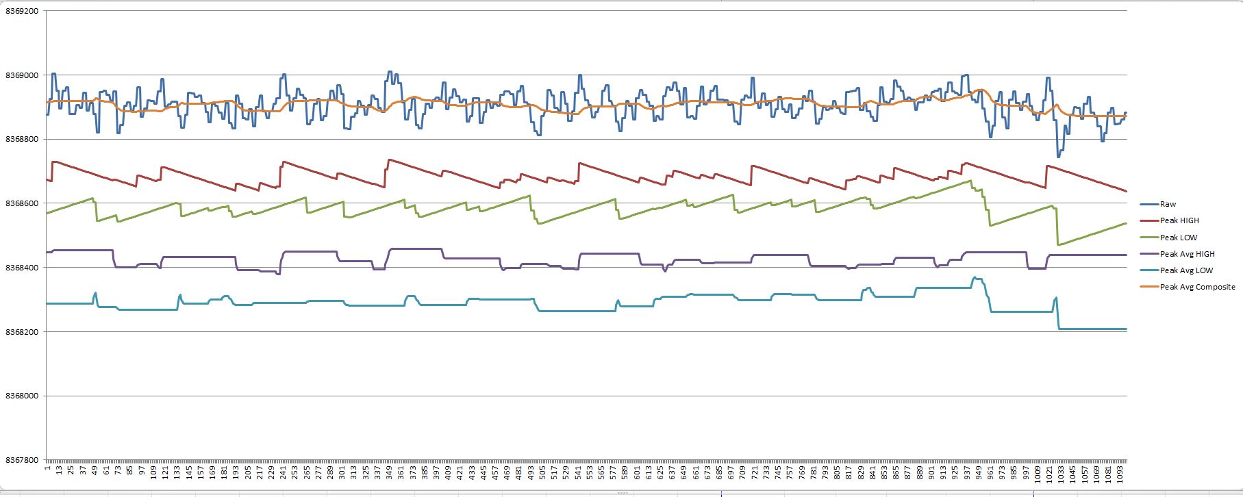

Ok, So here is an attempt to filter the output of a HX711 ... The Blue line is the raw data from the sensor and the Orange line is the filtered result.
Basically I setup TWO peak detectors in software, one for a HIGH peak detector and another for a LOW peak detector with a decay of ONE for each.
For the HIGH Peak, the decay decreases the HIGH Peak value ... for the LOW Peak, the decay increases the LOW Peak value. 'LOW Peak' and 'HIGH Peak' are two separate variables shown in Red and Green. The 'Peak Avg HIGH' and 'Peak Avg LOW' are also two separate values that take an average each time the corresponding Peak variable is bumped up or bumped down.
PSEUDO CODE:
    If RAW > PeakHIGH Then
       PeakHIGH = RAW
       PeakAVGH = Int((PeakAVGH + RAW) / 2)
    End If
    If RAW < PeakLOW1 Then
       PeakLOW = RAW
       PeakAVGL = Int((PeakAVGL + RAW) / 2)
    End If
    PeakHIGH = PeakHIGH - 1
    PeakLOW = PeakLOW + 1
The 'Peak Avg HIGH' and 'Peak Avg LOW' are then Averaged together in a 5 sample window average to produce the Orange Output
PSEUDO CODE:
    PeakAVGComposite = Int((PeakAVGH + PeakAVGL) / 2)
    DataBase = DataBase + PeakAVGComposite
    DataBase = DataBase - DataBase_Avg
    DataBase_Avg = Int(DataBase / 5)
Any thoughts or comments are welcome.... The idea here was to try to get good response without having to average the heck out of the original data wich introduces a sluggish, delayed response.
Note: I normalized the data from the HX711 sensor, so that it is NOT 2's complement, but a Centered integer instead.... i.e. -127 to 127 becomes 0 to 255 where the resting value is 127

The possible problem I see with that is that you are specifically using the peaks, so if it's a noisy signal it's picking up on the noise rather than removing it - but on the other side, it will respond quickly to changes.
I usually use a slightly different method for noise removal, though both sample rate and required response time will affect the suitability of any particular approach.
In principle, pseudo C style:
--- That's exactly why I am using a traditional High Peak and a not so traditional Low Peak. True noise should be random in both directions and for the most part cancel out. Even with noise present, the true signal derived from the Peaks should bias the direction up or down
