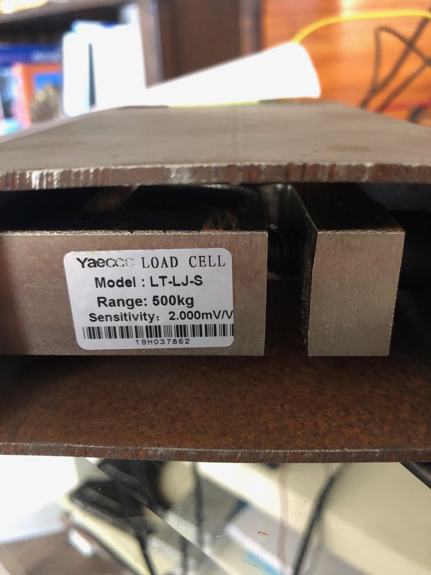

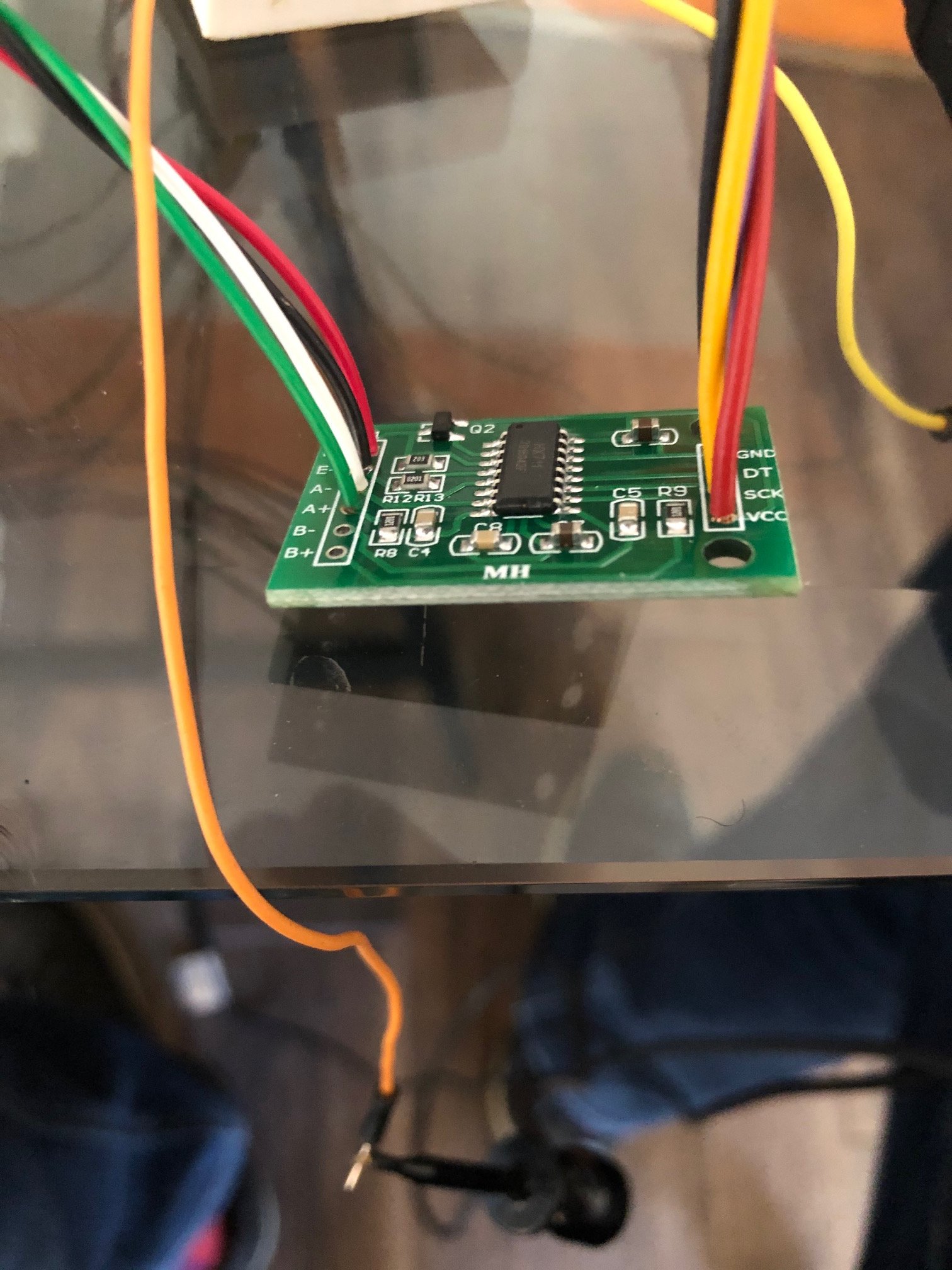

Hi All,
Just have a question on a S strain gauge I am trying to wire up. It has a small board attached to it (strain3.jpg). I cant find any datasheet on it, except the silly paper that came with it (strain2.jpg). The sheet says 'Excitation+-' and 'Signal+-' which are not amazing labels for electronics. I am going to assume the signal+- label is a differential which I will use to compute the load? I was going to read these using a voltmeter for testing, then use a microcontroller once I know the max voltage output.
To make things a little more confusing there is a 5th wire hanging off the cable bundle which is not connected to the little board this gauge comes with. is this the shield or to power up the gauge? I tried to apply 3.3v to the Vcc with the GND wire grounded then tried to read the differential. It reads 0.8v and when I load the gauge the value doesn't change. Slightly frustrated, I tried my luck with 5v at risk of breaking something, and still the same.
Any pointers on this I would greatly appreciate! Thanks, guys.

The 5th wire is the shield. That should be grounded.
You wire the red wire (Excitation+) to E+ on the board, and the black wire (Excitation-) to E- on the board. Wire the green and white wires to A+ and A-
The load cell sensitivity is 2mV/V which will be at the full load of 500 kg. That means that if you use a 5 V supply, you will only get 10 mV out when the load cell has 500 kg on it. That's why you need a specialised amplifier. I would expect the green and white wires to be at nearly the same voltage at no load. The voltage on each of them would be about half the supply voltage.
Hi Diver,
Thank you for your response. Looking at the wiring of the board, it is how you have said. The output wires I have available are red(VCC), SCK(Y), DT(Purp), GND(Blk) at the other side of the board, plus the 5th wire which I have grounded.
Once i do this and apply 5v, it reads 71 mV between the Y/Purp and never changes. If i use 3.3v, it is 0v between them. No load or load it is the same readings.

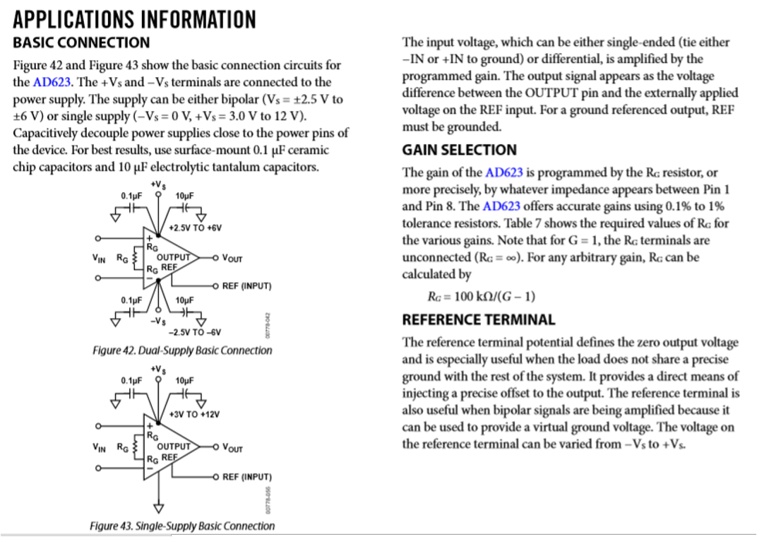

The simplest approach for a practical minimal system may be to add a zero-offset rail to rail opamp configured as a differential amp (or a dedicated differential instrumentation amp) between the load cell and MCU ADC input.
An AD623 may be suitable:
Adding a gain stage with a gain of eg. 200 to 250, which also changes the signal to 0V referenced, would mean it can be read directly by the ADC with reasonable resolution.
250 gain would give a 0 - 1.65V range, equivalent to an ADC range of roughly 0 - 3750, so each step around 134 grams.
A dedicated load cell converter (the 24 bit one already mentioned) would still give far better results, though..

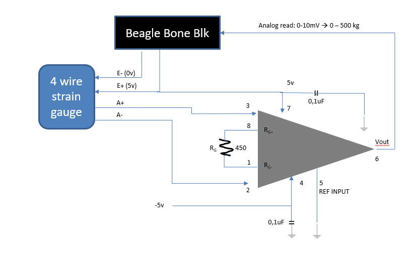

rjenkinsgb and thank you for the breakdown of the numbers, this was very instrumental. I think i will move forward with the AD623 as it will move me forward. How to get the -5v rail, just use a inverting op amp? Also, the 'INPUT REF' should be grounded i would think? below is a graphic of my understanding of how the circuit will work, can someone confirm, i would appreciate!
450 Ohm would provide a gain of 250, so i can tune this value to calibrate the sensor. Also, i do not think i have any electrolytic caps, do you think this will be bad?
Lastly, i assume that this amp will be in the dual supply configuration? I am really a noob, thank you!
  • ad623 - Operational Instrumentation Amp.pdf
I think you should be able to use the "Single supply" configuration, just using +5V for the opamp and strain gauge.
The REF goes to 0V, or the ADC analog ground terminal; the output voltage is relative to that terminal.

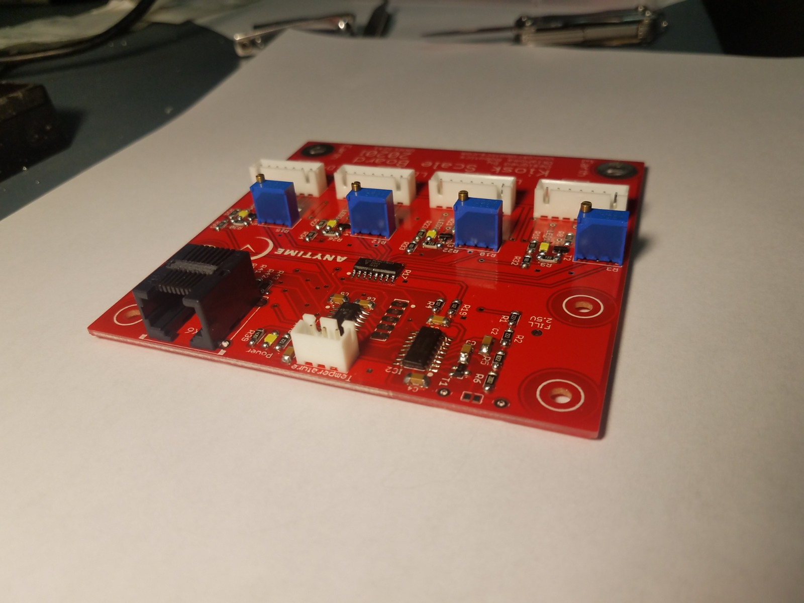

It does, but our client is not interested in the breakout board (we have that board as well) .... in this case we are designing our own board that functions as a load cell combiner with the HX711 chip on the board itself.
Attached is a completed board... The HX711 is on the front of the board on the image
