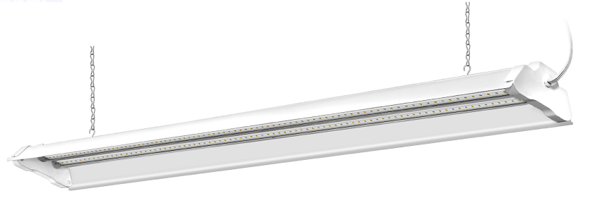

I recently had to change to 4 foot LED lights (because I could not find any replacement flourescent fixtures). When the washing machine runs, they flicker. Any thoughts on the cause (beyond the fact the washing machine is running) and anything I can do to get them to stop?

These are direct 4 foot LED light fixtures. The "bulbs" are not changeable.

4 foot LED light fixture. Full fixture with LED lights installed. All in one units, no tubes or bulbs.

Do you have a link to the actual light?
One (math) mistake I noticed afterwards, and perhaps a warning to others, this light is 4500 lumens. Two rails of LEDs for a total of 4500 lumens. I thought great more light than the T-8 bulbs which are 3200 lumens....T-8 bulbs are 3200 lumens each. 2 x 3200 = 6400 lumens. Therefore a 30% loss in lumens.
