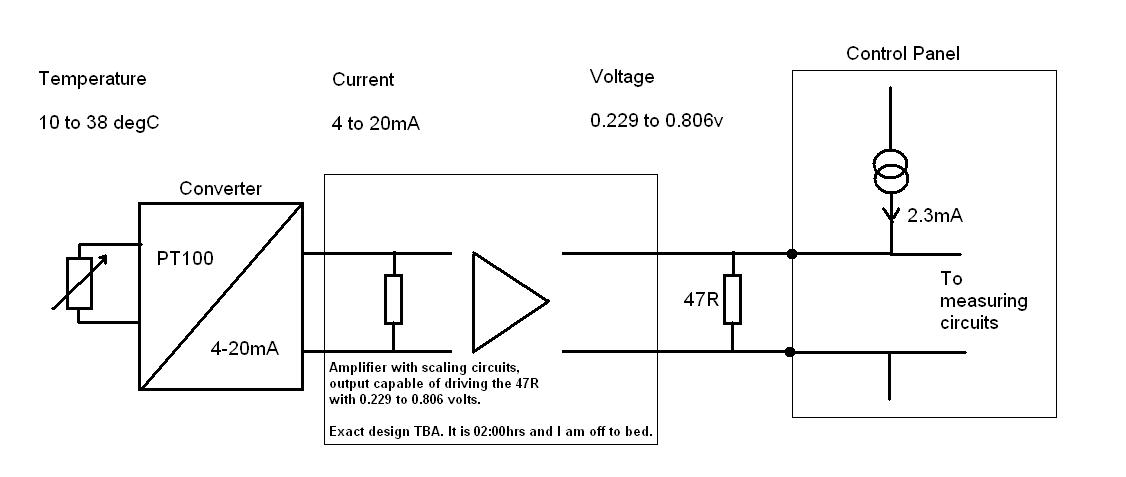

You show 10 to 38C=4 to 20mA. 1.75C/mA
Ron,
It does look like that in the drawing, but that was not my intention.
What I was trying to show, was that at that point in the system the signal was of 4 to 20mA form, although we are only using part of that range.

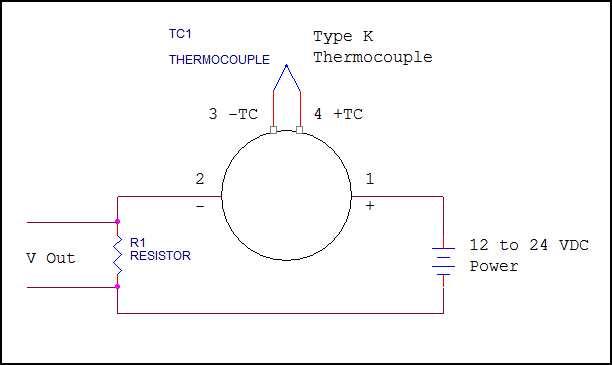

Along the lines of Jim's thinking here is something you can try. Using this concept with your temperature transmitter replace R1 below with around a 37 or so ohm resistor. Take the output and run it into your module.
Now we know you have an RTD and not a TC but you get the idea. Your temp transmitter is 0 to 100 C = 4 to 20 mA. We know or at least think your module has a fixed current out of around 2.3 mA for resistance measurements. So essentially we will have a fixed 2.3 mA source and a variable source in parallel with a 37 ohm resistor across them. I believe based on your numbers posted in your original post and assuming 2.3 mA fixed we should get 4 mA + 2.3 mA = 6.3 mA = 0 degrees C. Then 22.3 mA = 100 Degrees C. In keeping with your voltages as inputs using a 37 ohm resistor should work. The parallel currents should be additive forming the voltage drop across the 37 ohm resistor. Yes, 37 ohms is an odd resistance but try a pot or anything close to see if we get close.
You end up with a circuit that looks like the below image.
I1 is the internal reference current and I2 is your source current from your 4-20 mA temp transmitter. The drawing obviously isn't exact but you get the idea?
The plots look like the below attached thumbnail.
If anyone sees why this won't work please by all means correct me. I am not at all sure it will work but should be easy to try.
Ron
<EDIT> See post #30 </EDIT>

Ron, while I am not sure about this the PRT is a 0 to 450 degrees C PRT. It should use the standard PRT 100 chart. However, the temperature transmitter is a PRT type for a PRT 100 probe scaled for 0 to 100 degrees C = 4 to 20 mA. So the temperature transmitter will linearize the PRT curve (the ones I have do) and output 4-20 mA. So it really matters not at this point what the probe range is. That is my thinking on it anyway. All in all 0 to 100 C = 4 to 20 mA. All of the temperature transmitters like this I have worked with have done the same, be it a PRT input, T/C input or a host of other sensors.

Hi Jim and I understand what you are saying. You are absolutely correct. I scaled it all wrong. How about a 67 ohm resistor? Actually it would be nice to use a 100 ohm 10 turn pot and shove the probe in an ice bath and adjust the pot for 0 degrees C which should be around 67 ohms.

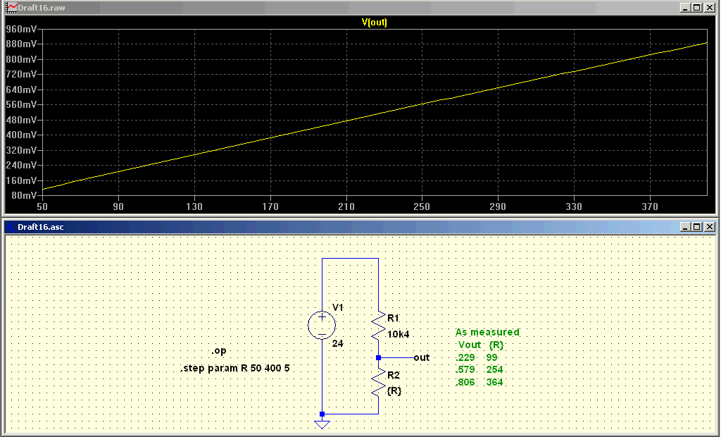

The constant current source in the instrument could be simply a nominal 10k resistor fed from 24V. Simulation shows 10.4k gives a pretty good match for the observed voltages/resistances.

Fleshing out the above ideas a bit, here's where I've got so far on the assumption that 4-20mA corresponds to 0-100C.
R1 sets the scale factor V(in)/I(probe), and a current source subtracts a current offset.
  • InputTest.asc
Alec, as drawn that looks to be a very good solution. I like it because it only focuses on the desired range.
Ron
Ok. Here's how I see it.
Edit: Q2 dissipates up to 450mW so should be a 2N2222 or similar rather than the 2N3904 shown.
  • InputTest2.asc
