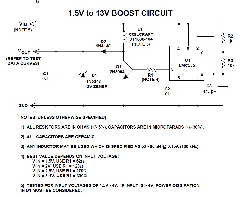

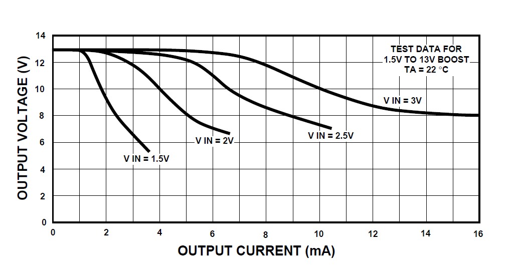

Here is a very simple boost using transistor and 555 timer. If you want 9V out, just change to a 9V zener on the output. With 3V input, you can get 9V out at about 12 mA.
Tx Boost
It ain't pretty, but I think it works.:eek:

That looks like a simulated circuit. It's missing some parts. There is nothing on the base of the switch transistor Q4 to turn it off.
