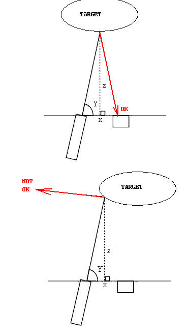

ok lets start off with a laser (with a truly fine beam ;)) and its on a flat plane with the CCD.
Now lets call the distance between the laser spot on the CCD and laser diode centre x meters and the angle of the laser towards the CCD Y degrees and the distance to the object z meters. Also the CCD is a VGA 640x480 pixel one and arranged so that the 640 side is parralel to the plane. With most camera's u can select the region to view, so u can choose 640x10 pixels to cut down processing.
Anyhow, some simple trigonometry gives: tanY = z / 0.5x => 0.5x.tanY = z
And volla, only difficult things are getting the distance to CCD, but it would be much easier to just use some experimental data to create a lookup table for a desired value of Y.

there could be some problems...

yup, but the same will happen with ultra sonnics unless u use a very wide 'beam' which would lose much of the resultion needed to create a sensor.
well if he beam should "fly away" like that then why doesen't the beab fly away in sharp Ir sensors? they get accurate readings even if the object is angeled 100degrees and tilted upwards... it uses IR beams also, doesen't it?
well, i wouldn't call it accurate. in fact it's accuracy (Sharp sensor) is quite poor (i do have few of them).
you just have to evaluate from case to case if the sensor is satisfactory for the application. decent sensors are often very expencive but the output is not affected by temeprature, color of the target etc and they will have linear output and visible red beam for easy alignment. however the price tag of $1000-1300 per sensor will make you think twice before placing purchase order :)
