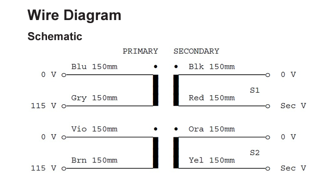

The fuse for the supply is 1 A, so that represents 120 W. You need a 120 W or larger trnansformer.
You could use this:-
https://www.newark.com/multicomp-pro/mcta160-18/toroidal-transformer/dp/38K4911
The 36 V input would be what would normally be the secondary and you need to wire the two windings in series. That would be done by connecting red to orange and connecting black and yellow to the 36 V ac supply.
The two 115 V windings, marked as primary but being used as the the secondary, would need to be in parallel. Wire blue to violet and to the live connection of the load. Wire grey to brown and to the neutral connection of the load.
The dots on the winding diagram are important, and you cannot swap one winding (eg blue to grey) if it is connected to another winding.
Note that the transformer output voltage is at rated current so the no-load output voltage is some higher than that to compensate for the resistance of the windings (defined as its regulation percentage).
Unfortunately this works in reverse when using the transformer backwards, so applying 36V to the secondary will result in some less than 115V/120V at the primary.
That may not be a problem, but it's something to keep in mind.

Hi again, just to check before I order will this transformer work I know it has a higher va but it isn’t on back order. Thanks, Matthew.
That 225W / 18V transformer has a no-load voltage of 19.2 V. I assume that is at 230 V input.
That would make the turns ratio very close to 12, or 6 if both are in series. That would give about 215 V if the input voltage is 36 V exactly and there is no load.
Have you measured the 36 V output from the welder?
Ended up finding a seller for the transformer that was recommended for me by you. Measuring the output from the welder with the multi meter gives me, around 37 volts.
The 160VA transformer has a no-load output of 19.6 V. That should give 217 V from 37 V at no load.
217 V is unlikely to be a problem with any small 230 - 240 V appliance.

Just to be clear, are you saying with no load ie. Motor not running the power supply will receive 217v, would this not damage it when it’s designed for 120v ac input? Thanks
That would damage something rated at 120 V ac. I had (incorrectly) done the calculation based on putting the two windings in series to aim for 230 V.
With the two windings in parallel, the voltage would be halved at 108.5 V with no load.
