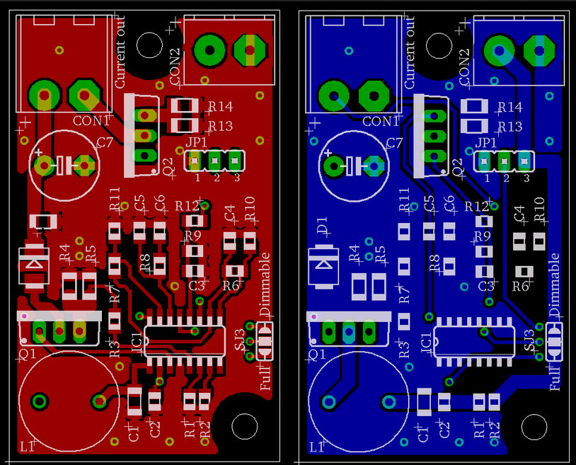

I am attaching the board layout if anyone is interested. The shape and size of board as well as location of connectors was dictated by other constraints. That said I don't think the layout is too bad as a first pass???

I would use a smaller size wire to fill ground. Look at CON2 and CON1 how I filled on around the connector.
Also around R2 I filled in some ground.
I added a small cap from D1 to ground. The idea is to get current back to ground faster. (back to R4,5)
I wish you could connect the ground end of C1 to the ground end of R4,5 and C7. That should be a short connection.
For power supplies, using SMT, I do not use thermals. I talked with several production houses and they do not have a problem with that. I understand why thermals are used with flow solder, but with IR soldering or oven soldering the thermals are not needed. (some people will disagree)

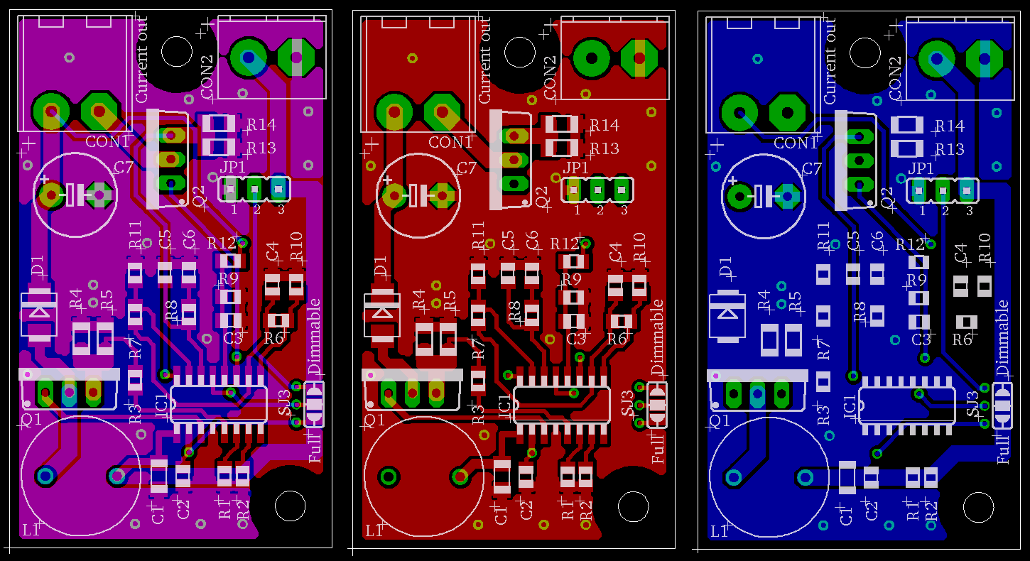

Thanks for the improvements.
I think I'll re-visit the layout and see if I can improve the ground between C1 and R4,5 and C7. Past experience tells me I'm always going to end up with one long run somewhere but maybe I can improve upon what's there.

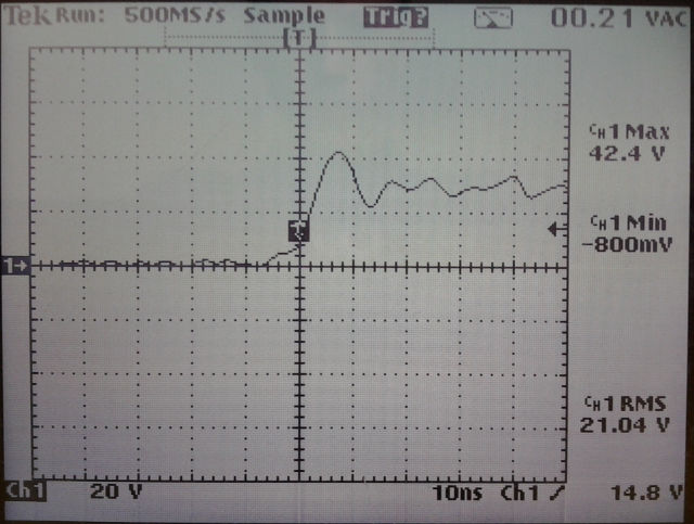

As a matter of interest I measured the MOSFET drain with the idea of adding a snubber. Photo attached. The spike isn't too bad, going to just over 40V before returning to steady state 30V. The oscillation looks to be around 100MHz but dies out pretty quickly. It's right up near the top end of my 100MHz scope's capabilities so I'm wondering how accurate the reading actually is. I think I'll make a spot on the next PCB for a snubber in any case.
The AC drill is an example of a product that could fail FCC tests. The cable makes a great antenna and the brush arcs, a great impulse generator.
The cheap radio works well to verify this.
Putting this radio near the LED driver swamps the front end to turn down the gain of the AGC control thus quieting the radio.
Putting the radio near the light picks up the modulation with less dramatic effects on AGC but audible on speaker.
The cordless drill works as a good example of low EMI.
If you can find similar noisy products but with an FCC ID then you have a good benchmark for reference and a good cheap tester.
A large CM choke on the LED cable, should give good reduction without loading the MOSFETs.
