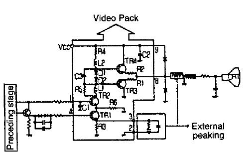

The amp hybrid is a VPA30; the data sheet is attached in post #8.
Let me ask a hypothetical question, in the circuit attached on post #5, assuming the op amp slew rate was insignificant compared to the operating frequency of the amplifier, would the output of the circuit create significant distortion?
ok, i see now.... the VPA30 is already biased class AB, so there's not a lot you can do about that. if you look at the output transistors, you will see a pair of forward biased diodes between the bases. this biases each transistor just barely on, so there's not a lot of quiescent current there to begin with. assuming that the supply voltage is about 100 volts, a 20mA idle current is about 2 watts of dissipation. with signal this will increase quite a bit. the module is a very simple amplifier. i don't think you will get the performance you are looking for using an opamp. power op amps that can handle the high rail voltages have nowhere near the bandwidth (300khz, NOT Mhz) and opamps that have the speed are low voltage devices. you could make a hybrid amp with a high speed op amp and a similar output stage as what's in the module, but you still have about the same amount of heat to contend with. your amp diagram in #8 might work, but regardless of feedback through the op amp, the transition between conduction on the transistors will still cause crossover distortion. part of the problem there is the op amp tries to slew across the conduction potentials and at high frequencies the slew induced distortion and the crossover notch distortion will become very noticeable. high frequenct op amps also have a tendency to oscillate during the swing through the transition zone, because like clipping, it's a circuit condition where there is no useful feedback. in digital logic this would be called an "undefined" state, just it's an analog version of one.
ok, Your amp diagram in #8 might work, but regardless of feedback through the op amp, the transition between conduction on the transistors will still cause crossover distortion. part of the problem there is the op amp tries to slew across the conduction potentials and at high frequencies the slew induced distortion and the crossover notch distortion will become very noticeable. high frequenct op amps also have a tendency to oscillate during the swing through the transition zone, because like clipping, it's a circuit condition where there is no useful feedback. in digital logic this would be called an "undefined" state, just it's an analog version of one.

if you look at the VPA15 data sheet, under the heading CURRENT CONSUMPTION, the actual operating current with signal is closer to 100mA. idle current of a class AB amp is just that the current when the amp has no signal and is driving no load. the operating current is the average current with signal and driving a load. the cathode of a CRT has current flowing all the time there's high voltage applied to the CRT anode. that's the beam current, and it comes through the module. you are actually sourcing the beam current through the transistors, so there's a lot more than just the bias currents. the beam current isn't obvious here, because you're treating the cathode as a purely capacitive load, but you're actually feeding a voltage controlled current source (or sink, depending on how you look at it), and at all times except a short blanking period, there's beam current flowing. what you would have to do to simulate the cathode being driven, would be to download a tube model and use it with the triode symbol or the pentode symbol (closer to acting like the real thing, but even the triode would give you an idea what's going on here). granted, you would need a tube model with a -50V grid cutoff voltage, but it would better model the load you're driving.
I have designed amplifiers like this, and if you are planning to use this as a video amplifier, you will spend a very long time to make this work. The best configuration is a push-pull cascode circuit. This was the basis for TRW's (later Motorola's) wideband video cathode driver hybrids.

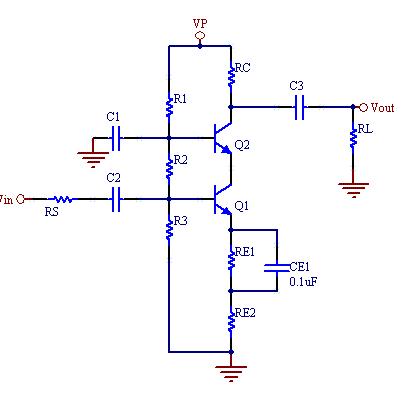

Once inherited a product that used discreet bipolar transistors, connected as a cascode with a inductively peaked resistive collector load, which achieved about a 2.5 ns rise time, but it required massive heatsinks for the transistors (the transistor's junction to case thermal resistance is pretty high because of the small die) and many watts dissipated in the resistive load. And this only provided about 50 V P-P swing.
Hybrid video amplifiers have been dominant in the CRT monitor industry for the last 15 years or so. I suggest you see if you can find a discarded color monitor and salvage the hybrid amp. And then the fun with layout and decoupling can start.

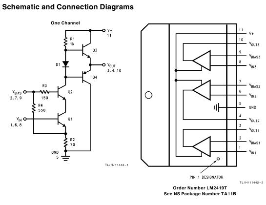

the driver stage of the VPA30 and also NatSemi's LM2419 CRT driver chip are almost (but not quite)identical cascodes. you can see that there's a lot of similarity between these two CRT driver chips and the cascode amp shown for reference. the class AB output stage is not just there for current gain, but to isolate the cascode from loading effects. two advantages of the cascode amp are 1)improved linearity due to the nearly constant Vce of the lower transistor, and 2) the capacitances of the two transistors are in series, reducing the total miller capacitance to less than the capacitance of either transistor alone (greatly improving high frequency response).
