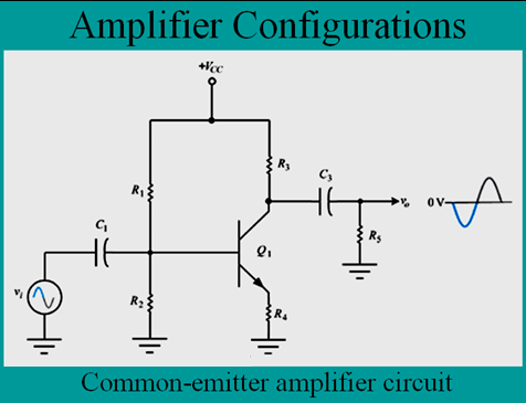

- I am making a subwoofer box for my room, which its specs are 8" 4ohm subwoofer feeding by about 100w.
- I put about 30 leds that lets say, they are directly connected to the power source 24V DC of course with their resistors, they are always OFF because I still have to work in a switch that switch them at the rhythm of the music.
- I initially thought using a tip31, with the base connected at the output of the "pre" amp, so now this tip31 will switch the leds that I mentioned. I am doubting about this idea (some people use it as a basic vumeter of single led) and yes, I need all my leds on/off at same time, not like those classic vumeters, I said that I although this is a good and basic idea, I think that this will low the quality and strenght that pre amp delivers to the line in of the amplifier, is not it?

Like we discussed on the other website, when the volume control is turned down then the LEDs will not light and when it is turned up then the LEDs might be on all the time.
You need to take the line output from the preamp that is before the volume control, amplify it to a few volts with a little transistor that does not affect the audio and it drives the TIP31 that gives current to the LEDs.

I ended concluding that as well, that's why I decided taking signal from the pre amp. :( I dont know how to add a little transistor before the tip 31, if I dont do that, its like the pre amp signal and quality will be compromised? or really tip31 wont take big amount of signal? if so, can you help me locating a little schematic that does that? Thanks so much.
We can show you how to make a little transistor circuit to boost the signal voltage and current to drive a TIP31 power transistor. Without the little transistor the signal level from the preamp output is too low to drive the TIP31 power transistor.
Repeat: The peak line level consumer voltage is only about 0.32V but the base of a TIP31 transistor needs up to 1V to turn on LEDs.

The cheap no-name-brand Chinese class-D amplifier you bought from ebay has no audio spec's and no preamp output. Its input is only Bluetooth so the LEDs must be driven from its output if they do not draw too much current.
