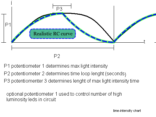

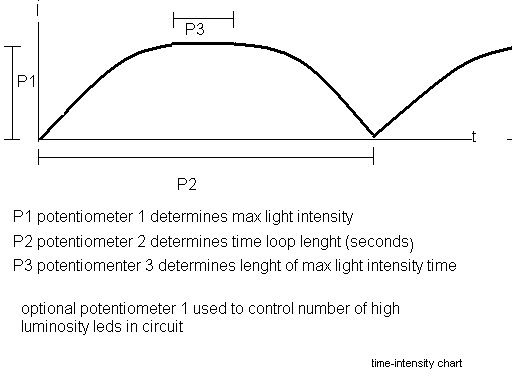

I've tried to build a circuit to perform fade in - hold - fade out loops. Now i have this challenge to insert 3 potentiometers to control time loop lenght, maximum brightness and hold time each pot. Trouble for me is to resolve need for long RC time constant when the 2 other potentiometer are controlling different parameters.
I've created a time-intensity chart to explain what am I talking about.
the loop time goes from 5 seconds to 20 secs, i guess it is enough to create an off time effect long enough to be noticed
I've assumed that the brightness potentiometer also defines number of HB leds in circuit.
thanks

Hi. I'm not sure I fully understood your request.
Is it very important that the curve is sinus shaped?
Is your project based on µPC?
How many LEDs and what current? You want to adjust brightness and be able to switch more on to increase brightness? If so how how many steps?
curve is standard capacitor based, it has no need for special algebraic shape... project is 100% analogue!... led number might vary but i left it out of core circuit because of the color change for each circuit i plan to build... switching is a good idea but it is also left it out of core circuit... high brightness leds have this versatility with simple resistance potentiometers...
Not exact that curve anyway
If curve is based on a RC pair, then the curwe won't look like your drawing anyway. It will look more like this (see atached picture).
It may be possible to produce round curve using integrators and differensiators combined with adjustable current mirrors. But I haven't any thaughts on how to make it that way.

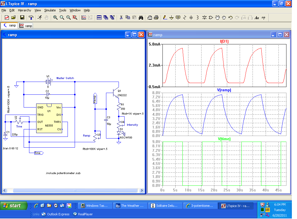

Ramp Circuit
See if this concept is about what you are looking for.
Be aware, it will only run 1 or 2 leds before the power is to high.
