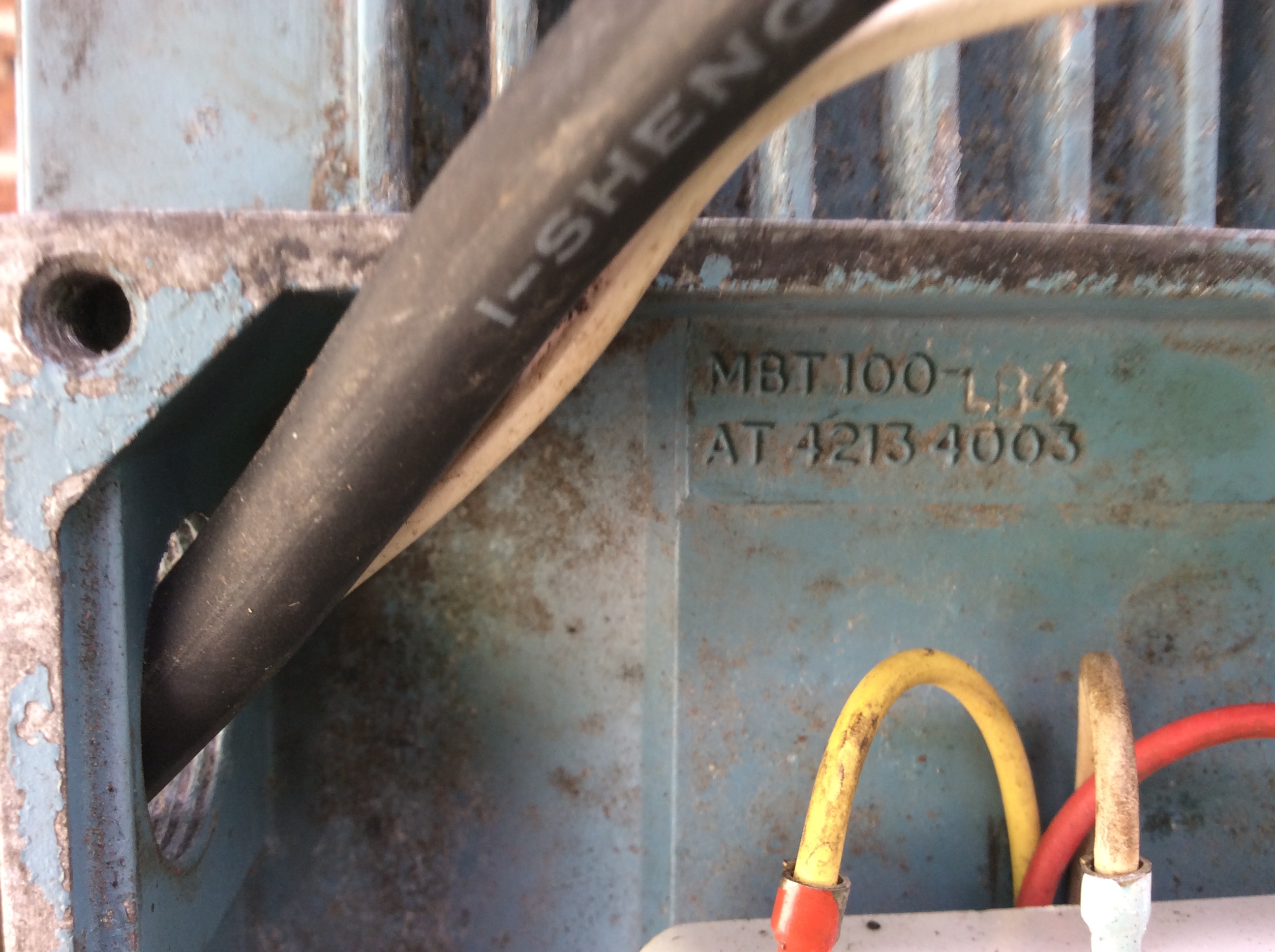

Having found the terminal cover there is the supplier with phone number .and a stamped number inside.

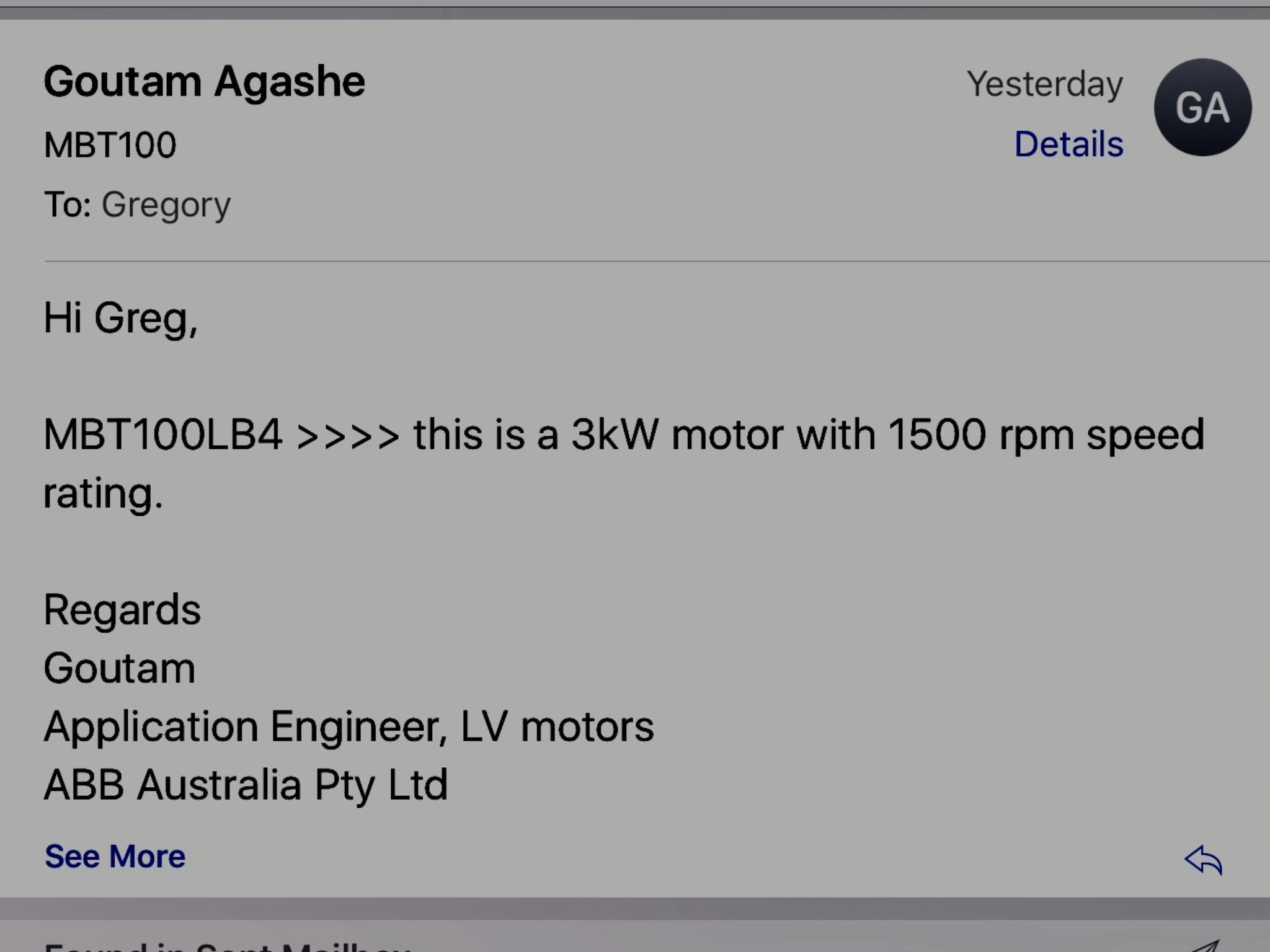

Having got in touch with them sending photoes . They replied with the information

Asea became ABB so that makes sense.
However 3kw's of motor would need in my opinion either a inverter drive or a rotary converter as described by Tcm.
Also an inverter drive would only work if the motor will run off 3 x 220/240, the data you got from ABB doesnt say this, 3kw is kinda bordeline so it could be either 220/440 or 440/660.
I had a quick look online, couldnt find anything specific about the Mbt100.
I would not have pegged it for a 4HP motor!
Also I assume the 1500 rpm is for 60Hz? It would not run at 1500rpm on 50Hz.
Max.
Yes the frame isnt big for 3kw, however we know very little about it, could be a short duty motor.
Kinda looks a bit like a hydraulic pump flange, something like a lift table would only cycle for a few seconds.
