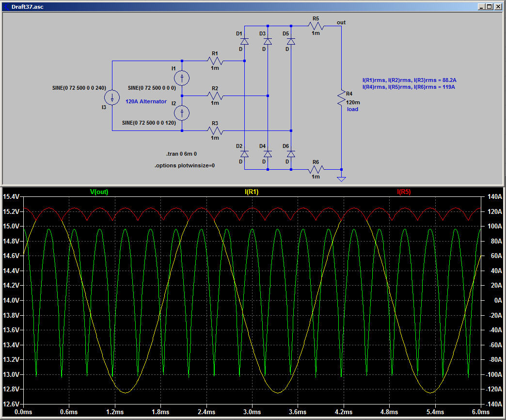

I am building a Remote Rectifier for a small case P style 12V 120A engine driven alternator that will have external voltage regulation. The reason being the alternator is located in an area of high heat and under a high constant load so wish to reduce the heat of the alternator so it doesn't experience as much output loss or burn up. The existing internal rectifier will be removed and the 3 phase AC taken off the alternators stator via heavy gauge wires (say 6g) to the Remote Rectifier. It will have a heat sink and a fan. The alternators voltage regulators power source will go via thermal switch on the Remote Rectifier's alloy case in the event the fan malfunctioned and the rectifier overheated thus causing the regulator to switch off the alternator. Alternator output should be in the order of 100A hot with this modification so not to over stress the windings.
My knowledge of bridge rectifiers in this application is only limited to knowing they are taking 3 phase AC and via 3 sets of diodes converting it to DC and their DC current capacity to exceed that of the alternator to allow some headroom. I assume any excess current capacity of the rectifier will simply mean it will operate at a cooler temperature? I have attached a picture of the bridge rectifier I'm contemplating which indicates it is a full wave module with 3 sets of diodes and rated at 1600v and 300A.
My questions are;
1. Other than the current rating of 300A is there any other rectifier specification that I need to be concerned about for this application?
2. Am I correct in assuming the 3 phase AC cable run length even at 6g will need to be limited otherwise DC current output will be reduced?
As you can see this is my first post so I would be greatly appreciative of any guidance and assistance given.

Think of it this way: Alternator x meters from load. You have a choice. The power is transported from alternator to load either on two wires (DC, rectifiers on alternator) or three wires (3ph AC, rectifier at load). Power lost is proportional to Irms^2 * wire resistance. What are the currents in the two or three wires? What does this say about wire sizing?

Nope, the DC wire only needs to be slightly bigger than the AC wire for equal losses. That is because the power is being carried by only two conductors instead of three.

The current in the DC wires is only 30% higher than in the AC wires.
Wow Mike. Your effort towards doing the calcs and diagrams incl wave is greatly appreciated.

I repeated the sim to ask about the rectifiers.
The green trace is the PIV required for D1 (the others are the same in all plots). Note that typical automotive alternator rectifiers are rated at 100V.
The yellow trace is the current through D1. The waveform has an average value of 39.7A, and a rms value of 62.3A.
The red trace is the power dissipated by D1, assuming that this is a Silicon Ideal Diode. The average power per diode is 37.7W. A real Silicon diode will have a higher dissipation because of internal resistance. You could do better with Schottky rectifiers.
If you move the six diodes out of the shell of the alternator, this raises some serious heatsinking issues. Note that inside the alternator, the diodes are mounted inside the metal shell, but are cooled with a built-in fan. To get rid of a couple of hundred Watts if mounted externally, the rectifier stack will need a big heatsink, with either serious convection or a fan.

First of any decent rectifier is rated for average amps which means that you don't need a huge amperage rating for rectifying three phase power. To be honest the diodes in your original alternator despite it being a 120 amp rated unit were likely not rated for much over 40 - 50 amps each tops. I have never found any alternators that used huge current rated diodes for their relevant amperage ratings.
Reason being for practical purposes to get 120 amps DC out of three phase AC they average current per phase would be about 34 amps which for our application a 50 amp three phase bridge would be plenty enough.
Next is realistic overhead voltage rating which for a 12 volt systems any diode with a 50 or more volt rating is way more than you need so the 1600 volt rating is just wasting power due to it inherent higher forward voltage drop which is likely around 1 volt Vs what a common germanium type diode which was commonly used due to it low forward voltage drop of ~ .3 - .4 volts at full load hence how they get so much power through a bridge rectifier with such a small heat sink even with air cooling.
So given that, by realistic and past personal experimenting with modified alternators of all makes and ages your alternator using 6 Ga wire for each phase should be able to supply a good 100+ amps at the 12 - 15 volt range it's rated to work at a good 50+ feet away! Odds are if it was a quality commercial unit that has a fair amount of reserve capacity that could be used to compensate for a bit of voltage drop in the lines even 10 ga wire for a 50 foot run would be more than big enough.
