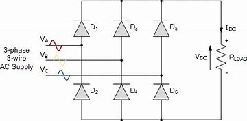

Yes it will work. You are only getting power form one line not all three. I tried this for a power meter and the end client rejected it because some time one line goes down and they wanted to keep the meter/computer running. So I made a circuit that takes power from L1,L2,L3 and will work if only line is working.
Simple answer is to use a off the shelf, single phase supply.
If you must take power from all there line I can help.
----edited------
Not my circuit but this is close to what I did. The use the "brick" power supply you mentioned there Rload is.
120433
---edited again-----
I need to go to work now. My design included the neutral and could run from only one line if needed. I will try to find it later.

Here are some things for you to think about.
Some times you only have 3 Phase with no neutral. That can be a problem.
If you always have a neutral then it is easy because almost any supply can live on the 240/120. You can live on any or all phases and neutral.
The 3 phase no neutral is a little hard because almost no common power supply works at 415 volts ac. I have a prototype I built for a metering project using parts from Power Integration.
If I remember right; last I had to build a supply that works from 80v (120 low line) to 440V ac. It would have been easier if the 80 volts was not there. Or easier of the 440 was not there.
IRM-20-12
12V 1.8A 21 watts. Is there a chance you can live with less than 21 watts?
Please find out if neutral is always there. What is the lowest and highest voltages? How much power out of the supply?

Certainly this module is an overkill in terms of power capacity for the project, power budget is not yet determined but i would guess less than 100mA @ 12V . Neutral will always be installed ofcourse.
The simplest approach would be three of these, or similar:
Connect one from each live to the neutral for input, connect the 0V outputs together and use a schottky diode from each output to your equipment, so there is no back-feed if any phase is off.
