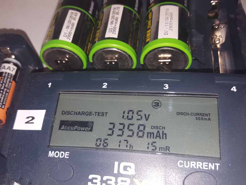

So here are the new results on the batteries
NiMh D - Sorted by Capacity
Date ------Time -BatteryIDCapacity Brand --- ----------Notes ------------------------------------------------------
11/22/2019 -09:18 ---D1 ---------3597 -------ThunderBolt (HF)Capacity shown is discharge capacity 500mA load
11/22/201909:19D73784ThunderBolt (HF)Capacity shown is discharge capacity
11/22/201909:16D24386ThunderBolt (HF)Capacity shown is discharge capacity
11/22/201912:01D84496ThunderBolt (HF)Capacity shown is discharge capacity
2 of the batteries consistently test at around 3660mAh (average) and the other two consistently test at around 4400mAh. I need 3 matched cells for the flashlight in question so as you can see I have a dilemma. As far as I know, all 4 were purchased at the same time but they appear to be from different batches.
CONCLUSION
The issue of one battery discharging to .80v while the other two were still at 1.29v probably resulted from one of the three batteries having a higher Capacity than the other two resulting in that one battery supplying more current than the other two and thus reaching exhaustion sooner.
If that is the case, then it could be summarized that in a series circuit, if there is a difference in capacity among the batteries, the battery with the highest capacity will fully discharge first.
I'm not sure this is correct but no one else has offered an explanation and this seems reasonable.
If that is correct, it will help going forward in various circumstances.

The tests above show the discharge values independently (each battery alone). Not in series.
The issue is their discharge in series in the above mentioned device (a flashlight type device in this example).
So far, the IN Series tests seem to suggest otherwise. It's counter intuitive I agree which is one of the reason for this thread. To find out if my test procedures or assumptions and observations are incorrect (most likely) or if there's some property of discharge that happens in batteries like this in series.
In series, there is only one current in the battery cells. That current is the same in all of the cells in series.
The cell with the lowest capacity becomes discharged first.
Good point. Thanks.
Battery University seems to agree. I have no idea why I experienced the issue that I did.
