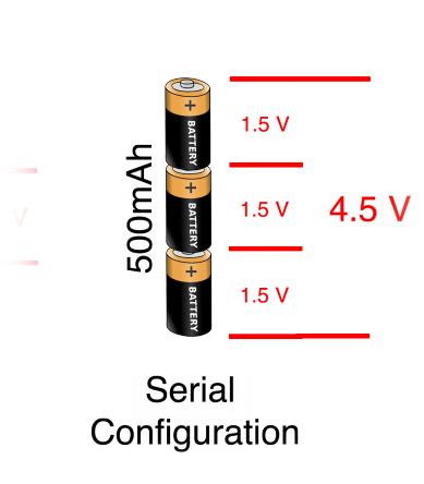

Are all 3 inline in a battery holder?
If not maybe the connections resistance is slightly lower on one causing it to burn out first.
Yes, they are in series with the positive of the battery beneath it directly touching the negative of the battery above.

Here are the most recent test results for the 3 D cells in question. They are HarborFreight Thunderbolt 2500mAh NiMh D cells
(The illustration above was only to illustrate how the batteries are configured and are NOT the batteries in question)
