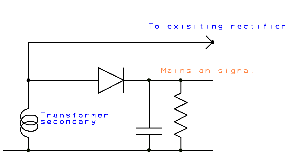

sorry, i wasnt clear, i mean to detect the ac voltage when it is applied to the charger, i want to be able to switch it on when i plug it in.
If you can get to the insided of the charger, you can connect an extra diode and as small capacitor the output of the transformer. That will give you a signal that is high (maybe slightly higher than 5V) when the mains is on and low when the mains is off.
The bigger problem is how you get that to turn the phone on and off. You can't just connect a battery to a phone and expect it to turn on, because it won't. You usually need to short the "on" button for about 1 second and then release. You will need a timer for that.
Also, you turn the phone off in exactly the same way, so you need some circuit to detect whether the phone is on before you start. You can just use a relay to remove the power to turn it off, and then when you restore the power, short the on button.

sorry, i missed your reply and played around in the mean time.
My working solution at the moment is as follows
Short out the power button indefinatly, this works on some phones, not on others.
I have a 5v minature relay detecting the output from the charger, when it is powered it connects, that then closes the switch from the battery to the phone.
Not sure how reliable in the long run but seems to work ok. Thanks for your above solution too diver
