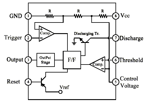

Have you looked at the block diagram for a 555? That may help make things clearer for you. If you give some more details, I'd take a crack at this, such as, what kind of switch (pushbutton, Normally Open?), what power supply, what load is being driven (a purpose would help: what are you trying to do?), what should the circuit do when power is applied? What parts are available? What constraints?
j.
hmm that block didn't really help... lol

Sorry the diagram didn't help... it helped me to quit thinking of the 555 as a black box and instead recognizing that it's just a few comparators and a flip flop, knowing this you can do some neater things with it.

The problem appear because the 555 is a level triggered monostable.
For use only 2 monostables cascaded you should use 2 edge triggered monostables, like CD4098 which have 2 edge triggered monostables in it, every monostable can be triggered on rising edge(low to high transition) or on falling edge(high to low transition).
If you want to use 2 555s then additional circuits must be added for have the desired work mode, because before you push the button, first 555 is in inactive mode(not triggered) and his output is low and the second 555 have the input 2(low trigger input) triggered so the second 555 have the output high all the time before hiting the button. After the button hit, the 1st output go low and free the 2nd 555 trigger input so the 2nd 555 output will go low after past of it time(0.5s) and will remain low until the 1st 555 time expire when it output go low and remain low, so 2nd 555 is trigger again and go high and remain high because it is trigger permanently.
If you use the pin 6(high trigger input) of 2nd 555 when hit button the 1st 555 is trigger, his output go high and imediately will trigger the 2nd 555 and is not god.
Use the both monostables from 4098, and connect 1st output to falling edge input of 2nd(TR- pin). When hit button, the 1st mono output go high and after it time his ouptut go low and only this high to low transition will trigger the 2nd mono. The trigger input can remain any time in low or high state, only follow edge(in case of use TR- input, or rising in case of use TR+ input) will trigger the monostable.
Hope this explains help you.
