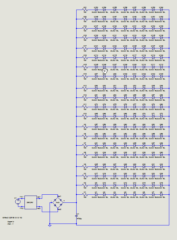

If you want to make it safe by using a mains transformer and you dont want the LED's to flicker then you must use a mains [230v] step down down transformer and a bridge rectifier with a smoothing capacitor. So thats a power supply.
Its bad practice to connect LED's in parallel and use only one resistor, it will give you LED damage problems.
So you will have to wire a ROW in series connected to the power supply as I have just described.
If you chose a 24Vac output transformer, you could drive up to 8 WHITE LED's in a 'string' with a single resistor.
You would have to repeat this for 20 strings of 8 LED's.
If the transformer and bridge rectifier has sufficient power you can drive all the 20 strings from the same power supply.
EDIT:
Like this, its 20mA per string, so 20 strings is approx 400mA, so 24V 12VA transformer and a 1amp bridge rectifier, the 4700uF cap must be rated at least 50Vworking.
I already found a way to use the resistors, i will use the DC current now.
I will supply 23mA to each LED, and i will create 40 strings (10 strings for each side of the chandelier).
It will use approx 1A of current, how many VA do you think the 24V power supply should have, a power supply with 1Amp should be able to power this up or you think i should get a more powerfull one?
The 1Amp rectifier and the 4700uF will still be enough or i need to change them too?

I will use 40 strings of 8 LED with 1 Resistor each string in DC mode.
It will be something like this:
__=___O____O____O____O____O____O____O____O__
....\resistor..............\LED
Then you need to use the circuit posted by Eric with a 390R resistor for each string.

You need a 24V 1A transformer and a 1A bridge rectifier - it's as simple as that.

I'm "thinking" in wiring the LED in series. It's as colin55 said previously:
"You need to convert the AC to DC via a bridge, add a 100R resistor and put LEDs in series until the peak voltage is reached (345v for 240vAC). Place a 22u electro across the LEDs.
This is how I designed LED strips for freezer cabinets. I used 3 parallel strings. I also incorporated constant current so the strips would work from 220v to 245v.
White LEDs need just 17mA.
But then i did some research about how "cool" is to power up the LED with 345V directly, and some people talked about excessive heating of the LED and if one LED goes down, all the other LED will down too.
I don't think i have any other viable option with that kind of design in mind, i even thought about using PWM to power up the LED, but i don't really know how to do that, and if it's viable in this situation.
Anyway my biggest problem it's the amperage, at least with my calculations:
100 LED @ 3.2v 22mA each
= 100 x 22mA = 22A!???
I'm doing wrong calculations or this design it's completly unpraticable?

Do not power the LEDs directly off the mains, they are not like lightbulbs and have very non linear characteristics and at least one will fail quickly and put your while string out, you are much better off (and safer off) using a transformer, as stated prieviously, to go down to 24v and rectifing / supressing with a cap. This will also massively reduce flicker which you will see if you run them from AC.
You could rectify the mains directly and use a cap to smooth, but you would end up with around 340v DC which will kill you instantly. Don't do it.
