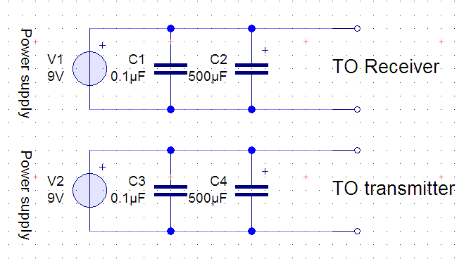

Looking at the two circuit diagrams I dont see any decoupling on the power rails.??
What I would suggest is to power each module thru its own blocking diode, say a 1N400x and decouple each module with a 22uF to 47uF cap and a 100nF.
EDIT: you could just add decoupling on the cathode ends of the two 1N4007's
Do you follow oK.?
I connected 0.1uf cap and 500uf electrolytic cap to transmitter and the same to receiver. The result was it still does not work. I tried to add just diodes but it did not help either.
Both of schematics I added were connected to single power supply.

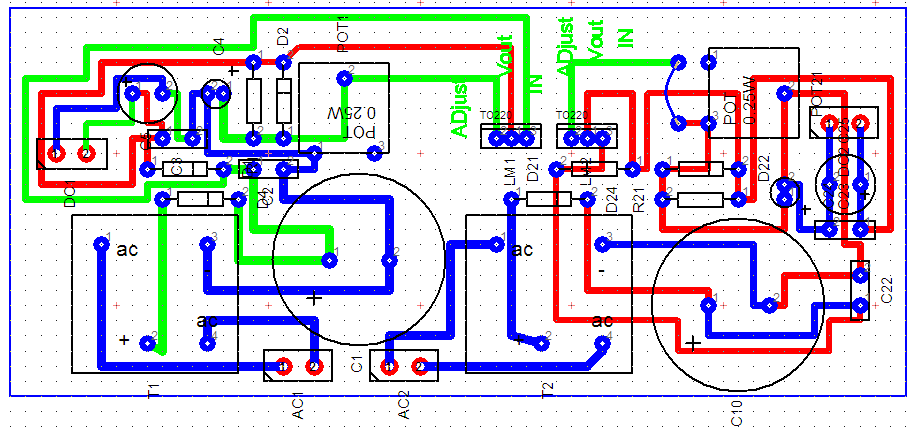

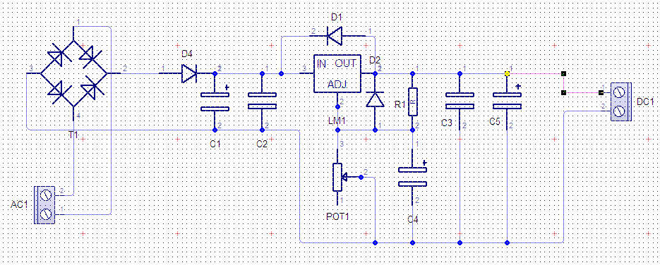

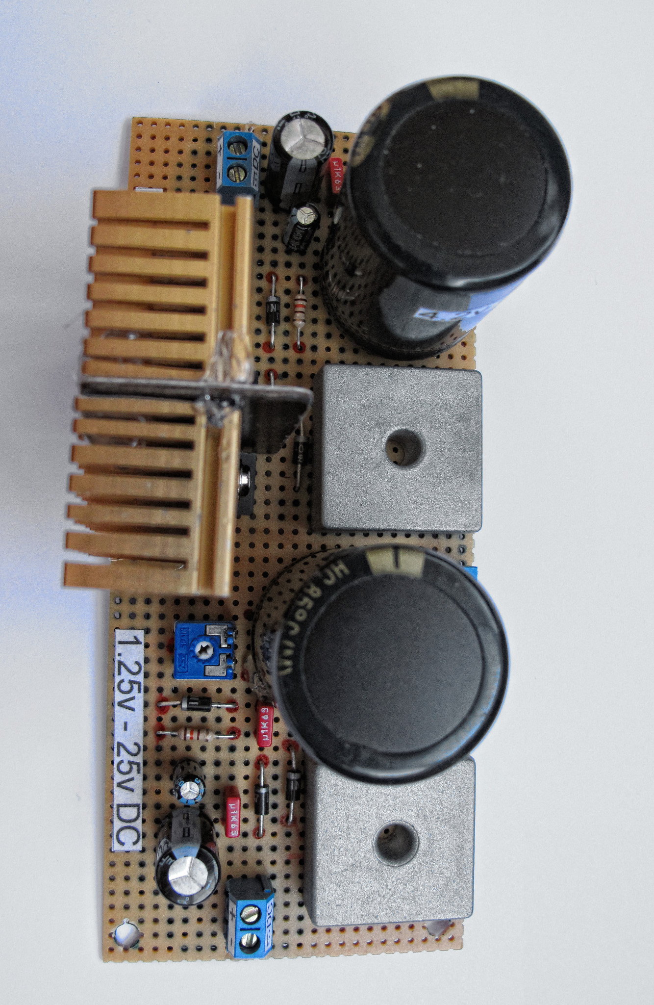

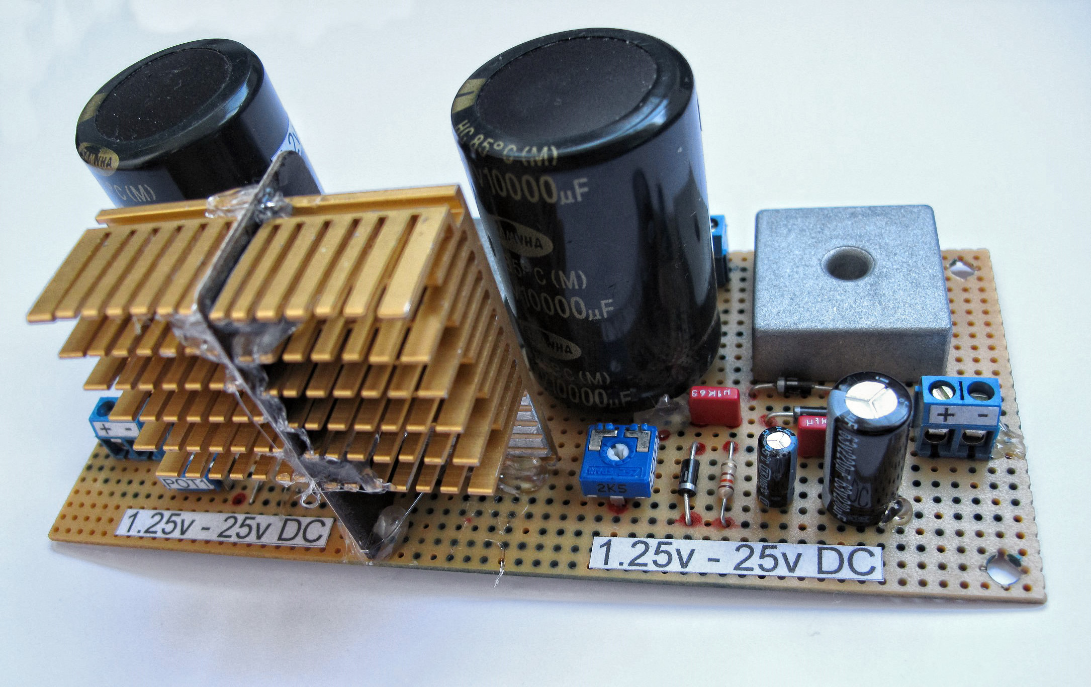

I'm using this PSU, in dual mode meaning the other PSU was conected to transformer with no load. I did blow my fuse 250mA at the transformer for some reason. I wonder if the fuse rating is correct and if LM338 needs a dummy load, remember I have dual PSU?
I attach my PSU schematics and photo.

I can't see why you want either such a big power supply or dual supplies.
Have you got anything else connected to the transmitter and receiver? If so, there could be a problem with connected power supplies.
How are you powering the two AC inputs on your power supply? To run them from separate sides of a centre tapped transformer would be wrong.
I will power a 3W LED and motor. The Transmitter and receiver will be powered by 9V (first PSU). 3W LED will be powered by first PSU too.
The second PSU will be used to power the motor via PWM driver. I made separate supplies to reduce noise.
See above.
I use simple transformer with 3 secondary outputs. The first is 15V AC goes to 9V, The second is 18V AC goes to make 12V to power motor.
